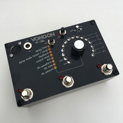

I just wanted to share a project I just finished for the MF-104SD, this is an Arduino based midi controller made specifically as a preset box for the MF-104 Super Delay. I've been using it for shows and it saves me a lot of headache trying to adjust all those knobs! I have made all of the code public on GitHub so feel free to use this to build your own Preset box. This is the 1st rev and it looks pretty goofy, but I would like to make another model in a real sturdy aluminum hammond enclosure. Any one out there want one of these?

Wow, nice. So does it work (out of the box) to support MF_104 only, or does it capture any number of CCs between 1 and n and then play those back to the target device when the preset is selected?
Ideally it would be extensible such that it could be used with other products which work via ccs such as the MuRF and Cluster Flux or maybe some of the Pigtronix boxes.
Re: MIDI preset box for MF-104SD
Currently it's set up to cycle through a large number of the parameters on the MF-104 (even "secret" ones not accessible from front panel). But your totally on point, it just sends MIDI CC messages associated with each preset, so yeah it could be used for any MIDI device that is controllable by CC messages! Although it would require some minor programming alterations for the different CC values associated to each parameter.

Not to take away from Ryan McGill's very cool preset box (nice user interface!), but here's a low-budget alternative (assuming you already own an iOS device):
Use any computer-based sequencer to create a single track that has a CC Message for every parameter you want to change on a particular MIDI Fooger (MF-104M, MF-104MSD, MF-105M, MF-108M). Save this file as your template and keep making new sequences by substituting new values for each "preset".
Get a low-cost iOS MIDI interface and a cheap (or free) MIDI Recorder for your iOS device. Put the iOS app in Record and play one of the tracks into it (usually takes less than a second). Name this file with your "preset" name.
Now you can dial up a tiny MIDI file by name on your iOS device and hit play and the MIDI Fooger will jump to your desired settings.

You'd need to send a midi PC into your iOS devise. Then you can use a foot controller live. MidiDesigner recognizes the PC # along with the preset #. Pretty cool when you combine it with a foot controller like the GigRig to switch your pedals.
My problem is that I have my iPad tied up in another instrument and I really don't want it on a pedalboard. In that case I could go the MidiSolutions Event Processor route, but you need to connect it to a computer just to edit it. Not as fun as real time editing on the device you're using. I vote for all in one solution like yours. Especially if it could recognize incoming PCs.

This got me thinking about how I can use Ableton Live as a way to manage presets and automation for my Foogers via MIDI. I have it all wired up (each Fooger on a separate MIDI channel) and they are ready to go, but I just haven't had time to dive into experimenting with this concept since way back when the MIDI MuRF was first released.
I planned to set up labeled MIDI clips to act as templates (as mentioned above).
Since I already program a lot of my old analog synths with MIDI clips, why not control the 3 MIDI Foogers too?
