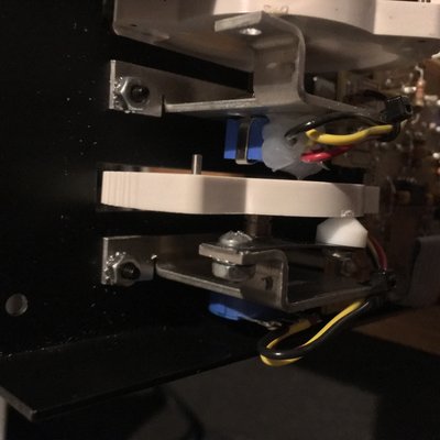

someone here posted instructions on how to modify that, using a smaller nut, or filing it down?
a search should bring it up

Interesting, thanks for the tip. I've played with it since I had to have it replaced which gave me an opportunity to study how it works when swapping it out. The Grandmother feels really smooth though. The spring-loaded-ness is pretty nice. I'll search out the instructions but I think a Moog mod would be ideal.

For those searching, this is likely the thread: viewtopic.php?f=2&t=28681&hilit=minimoog+pitch+wheel

yes!! that's it
the gist of it is in the last post:
"And while I had the left section open, I get rid of the nut between the wheel holder and the tongue with the cone used to hold the pitchbend very tidt into the center possition. Now it isn‘t that stiff anymore. And still no random MIDI values sent in zero position."
