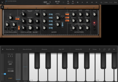

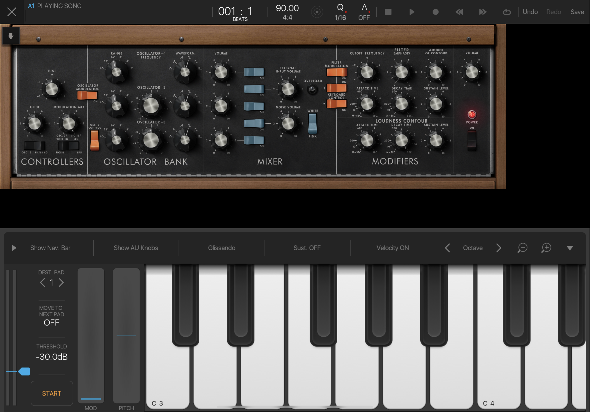

Although, it does look a bit weird in Beatmaker, see attached screenshot. Is this expected behavior?
Well, let’s hope that Apple gets its act together soon.
gbevin
Posts: 55
Joined: Tue Dec 06, 2011 10:34 am
Location: Asheville, NC
Re: iPad Pro 11 inch Issues
Post by gbevin » Tue Jan 22, 2019 3:04 am
Yes, that is expected behavior. The Model D UI is not scalable.
