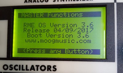

Hi there - suddenly my Moog Voyager RME (Boot 3.5 & Software 3.6) - has stopped "remembering " the Midi Enables for "ALL ENABLES" FUNCTION - ie The Voyager midi light is flashing but no sound is triggering UNLESS I go to :
1.MASTER - MIDI ENABLES - ALL ENABLES - SWT from OFF to ON ! Then the Voyager triggers via midi ok !
Then if I turn the Voyager off wait a few seconds then turn the Voyager back on - and check the Midi Enable/All Enables swt its gone back to OFF ! and I have to change it back to ON. Anybody know whats happening here ?? This is driving me nuts !! HELP !!!

Here you get the latest software version: http://www.moogmusic.de/RME_3.6_Beta.zip
Have fun,
Rudi
That's the problem: the boot version must be the same as the system version (3.6)Didge wrote:Boot 3.5 & Software 3.6

Hi there Rudi - all sorted out now - the sysex order is quite important - it took a few goes to get it right - Boot is now 3.6 and OS is 3.6 - the Midi Enables problem has now gone !!! Thank you so much !
