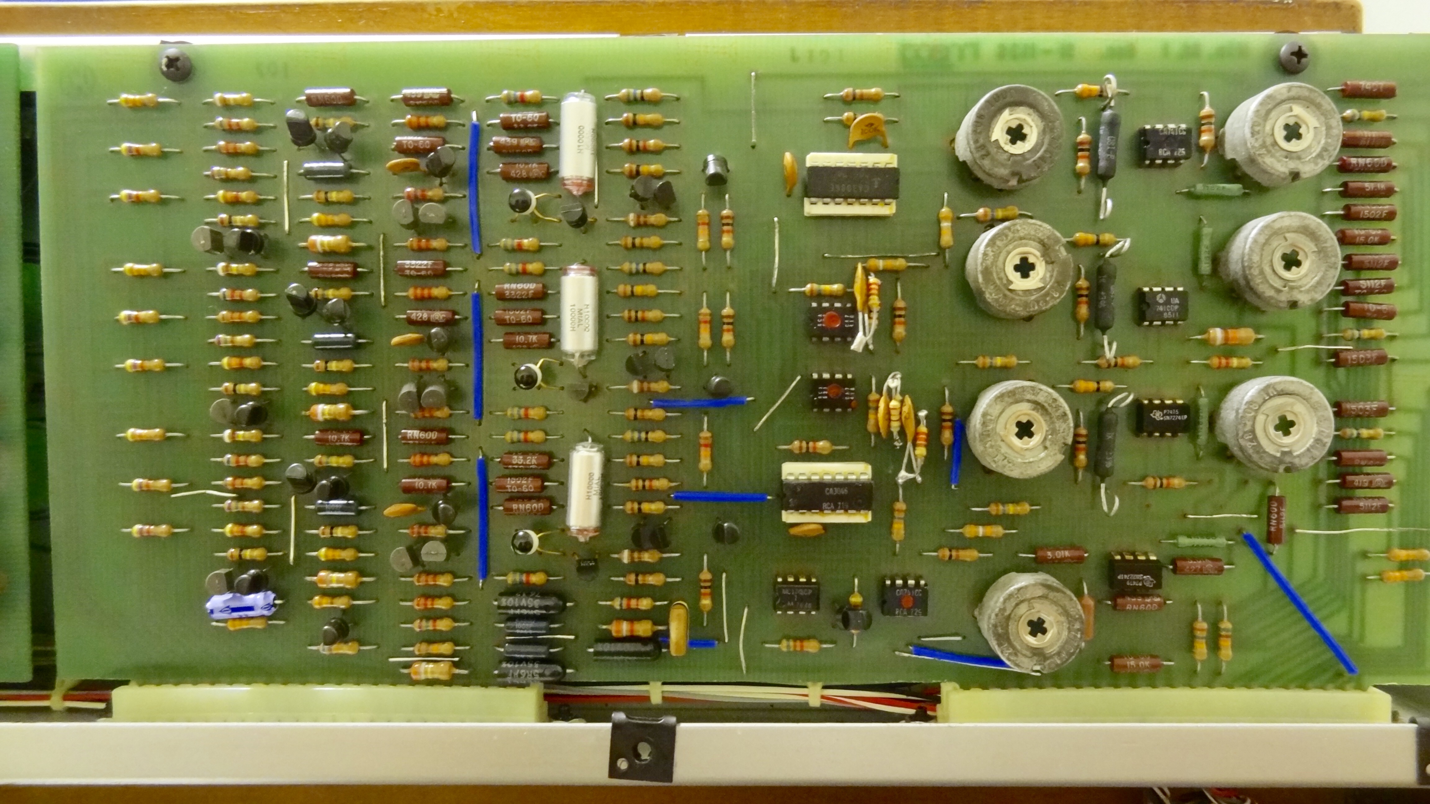

Here's a photo of the board

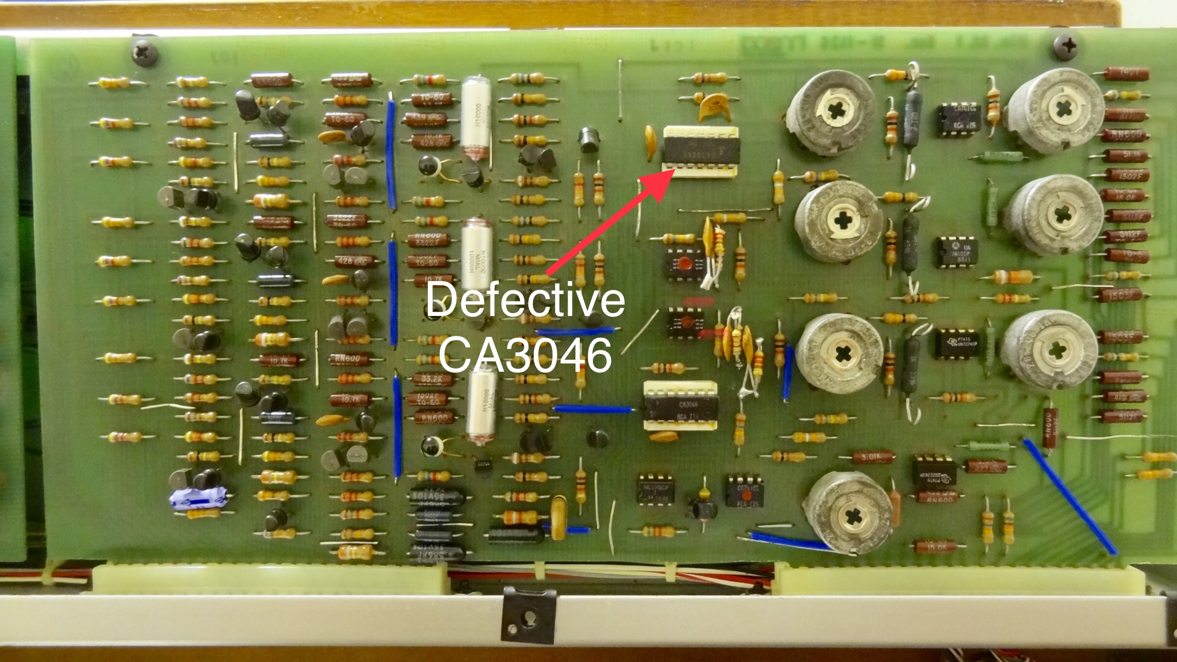

Post by normhart » Sun Nov 05, 2017 5:24 am
