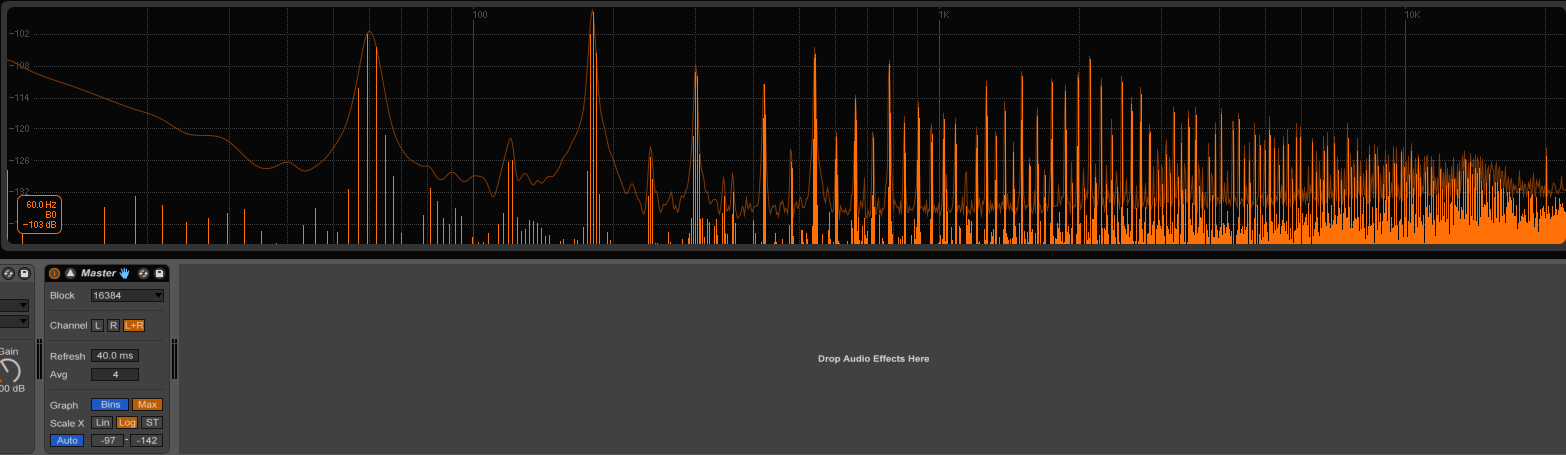

aas
Posts: 2
Joined: Fri Dec 14, 2018 6:36 am
Re: Sub37 Electrical Hum Issue
Post by aas » Wed Nov 25, 2020 1:28 pm
jtmatchett wrote: Thu Mar 16, 2017 2:39 pm This issue was resolved by switching to a TRS - TRS cable. Thanks for the help!
Thanks, switching TR to TRS cable helps.
See my Subsequent 37CV noise floor before and after.
Pretty good, including USB cable plugged !
