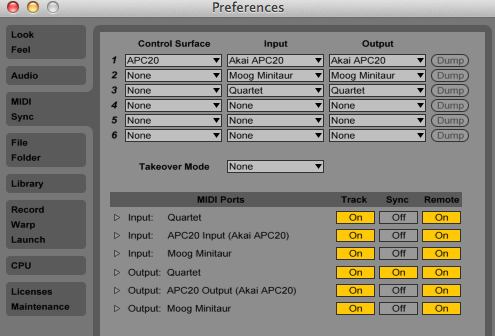

Thanks a lot, but in my case it is not working as expected... no sync, I would like the minitaur plugin to blink midi in matching with Ableton. And if you say "to turn On the Sync options for both Minitaur In and Out drivers in Ableton preferences" then Ableton will listen to the Minitaur, and I need the opposite.

Hi All!

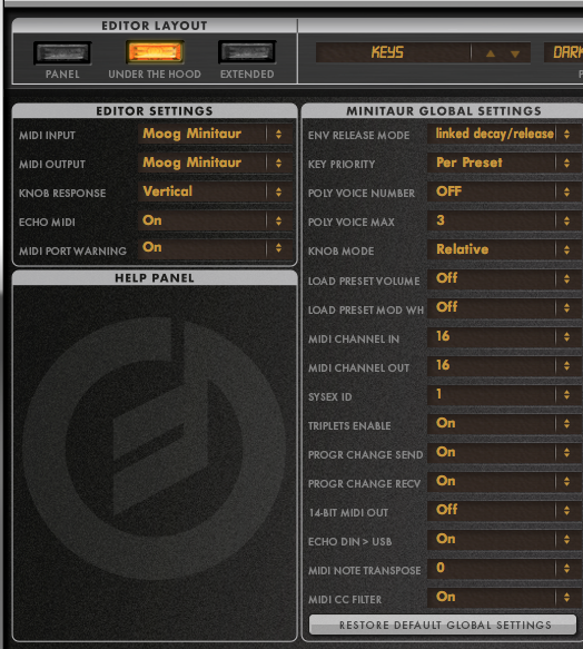

I believe the problem Szynkazmaslem is encountering here could be due to the MIDI settings in Ableton. In the screenshot of the MIDI preferences in Ableton, I see that SYNC for "Output: Minitaur" is turned OFF. Try turning this ON to see if this resolves the sync issue. All of your other settings appear to be correct. Make sure that you also have the LFO set to MIDI Sync in the "Under the Hood" tab of the Minitaur editor if trying to get the LFO to sync to MIDI. If you continue to have any problems or questions feel free to reach out to us directly through the following:
