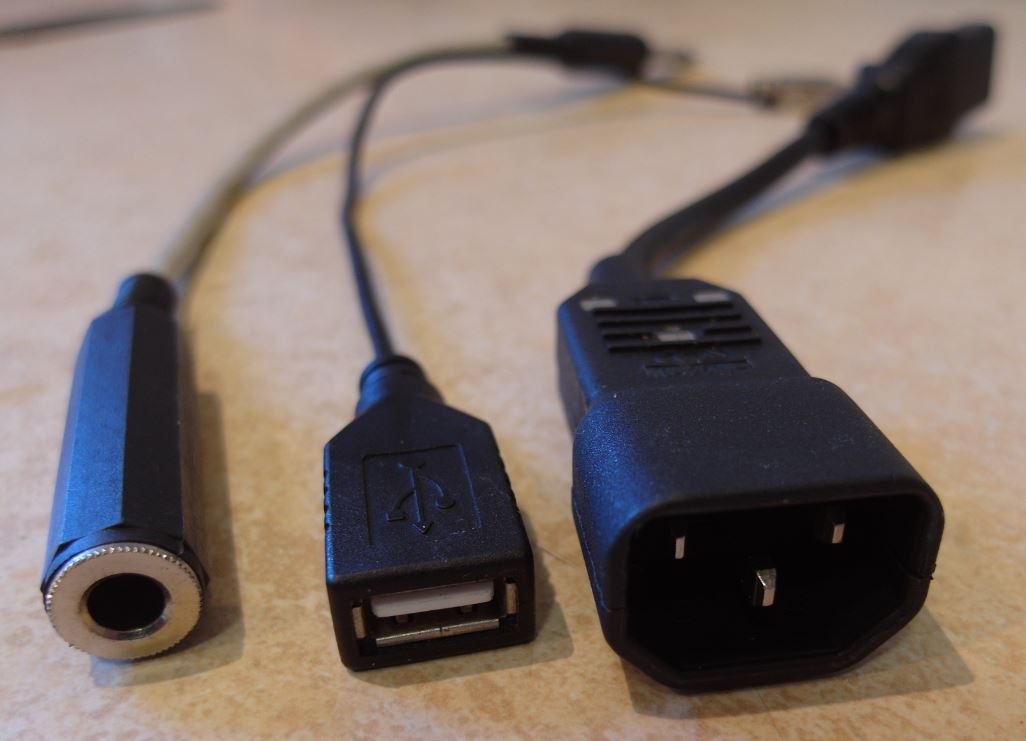

Hi mattymel,
Regarding taking your Sub 37 on the road...
Over time, the Power, audio and particularly USB sockets will loosen up and stop if you're plugging/unplugging every night. Expen$ive.
Short extender cables permanently connected can prevent this - see pic.
Thusly, you wear out the extenders instead of the Sub 37. Road case space may need adjusting also.

Hmm. Interesting. Seems like a good idea. Does Moog sell those in their site?
Just ordered a road case for mine yesterday which is the Phatty/Sub37 one with the storage space for cables/etc. Hopefully they'll be enough space for something like that.
