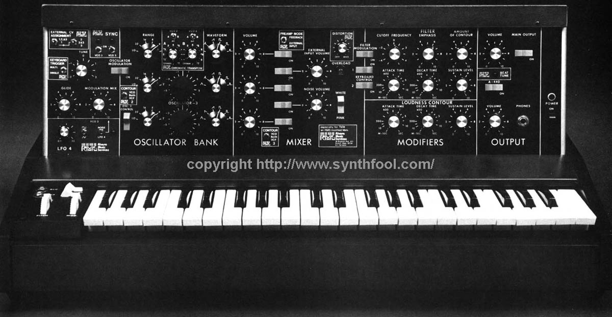

Ron Rivera was the one who hot-rodded Minimoogs.
Among other things there was a dedicated LFO, Hard Sync and a switch for Multiple Triggering of the Envelope Generators.

horowizard wrote:Ron Rivera was the one who hot-rodded Minimoogs.
Interesting at the time but makes the instrument almost worthless in today's market. Pure un-modded Moogs are what we look for. Factory originals.
