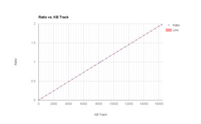

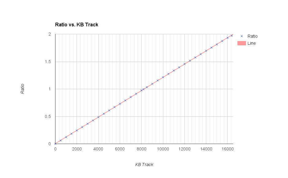

Thanks for your response. The challenge is though that changing the KB tracking also changes the cut off frequency. I am unfortunately not blessed with perfect pitch hearing so I need to add an oscillator for pitch reference and correct both cut off frequency and KB track to find the right range.
Fortunately the Moog engineers did a terrific job with the KB track settings: the ratio is nearly perfect linear in the whole knob range: I measured the self oscillating frequency of the filter for the lowest an the highest C on the keyboard for the whole range of the KB track (using the Sub37 Mac editor and the tuner in Ableton to measure the frequencies). For those interested the measurements and the regression fit As the fit is near perfect it is easy to calculate the 1/3 and 2/3 tracking :
1/3 : 2731
2/3: 5461
