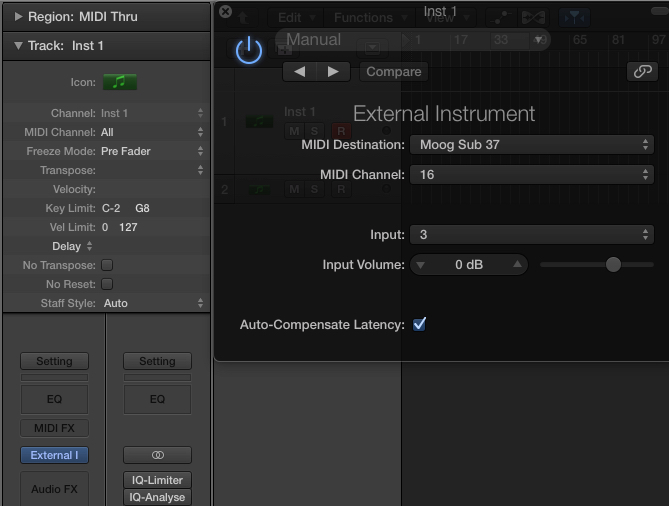

I had the same issue. You need to open the External Instrument and set the Sub 37 midi channel. Doing it in the Track Instrument panel does not work.
