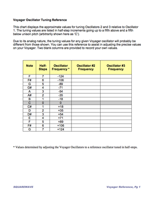

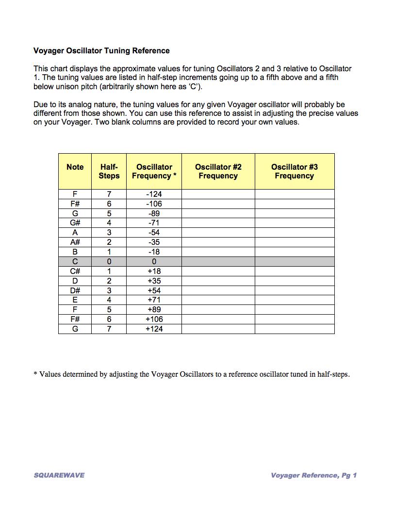

hi guys, new to the forum and a new voyager owner. tried searching but couldn't seem to find what i was after.
pent about a week messing with my voyager and now have been messing with midi control and trying to get my head around tunning the oscilators to make different chords or weird note combinations.
i'm a bit confused on the oscilator section, in terms of the freq and octave settings. specifically how do people know what note to dial in with OSC 2 & 3 in terms of the value? my music theory and maths isn't that great. is this possible to do on the fly? is there a chart or something to understand what values dial in what notes?

Here's a chart from the KnobTweak web site that might help:
You could dial in the notes from the chart on your Voyager and derive the MIDI CC equivalent value on your PC.

perfect. just what i was after, thanks man!

I tune by ear too. Due to slight calibration differences between units, panel hash marks or patch values don't always get the same results.
Re: Voyager Oscilator Chord Tuning Questions
Agreed! That's why I wrote:MC wrote:Due to slight calibration differences between units, panel hash marks or patch values don't always get the same results.
"Due to its analog nature, the tuning values for any given Voyager will probably be different from those shown", and included space to write in new values.
While fourths and fifths are easy, other intervals can be harder to discern by ear. The reference sheet can get you there very quickly.
