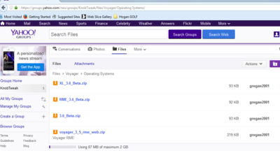

https://groups.yahoo.com/neo/groups/Kno ... 20Systems/JuneauUnderground wrote:Where does one find the May, 2016 3.6 Voyager OS. If its on the Moog website it is well hidden, or I am seriously browser challenged.

Ok, thanks in advance for those that are will to help us newbies. I have downloaded the XL_3.6_Beta from the links provided above. Expanding the download I get four files, XL_Bank_360_A, B, C and D, with a May 30, 2016 file date.
What exactly are contained in these files. I am assuming a beta update to the OS. Do these represent also represent patch files as well or is that just a peculiarity in the nomenclature. I know this is probably very elemental but I am new to the Moog world with my XL and I want to be very careful as I do not want to do anything to "Brick" my synth.
Also is there any outline or "How To" regarding the update procedure. I do appreciate any and all guidance.
