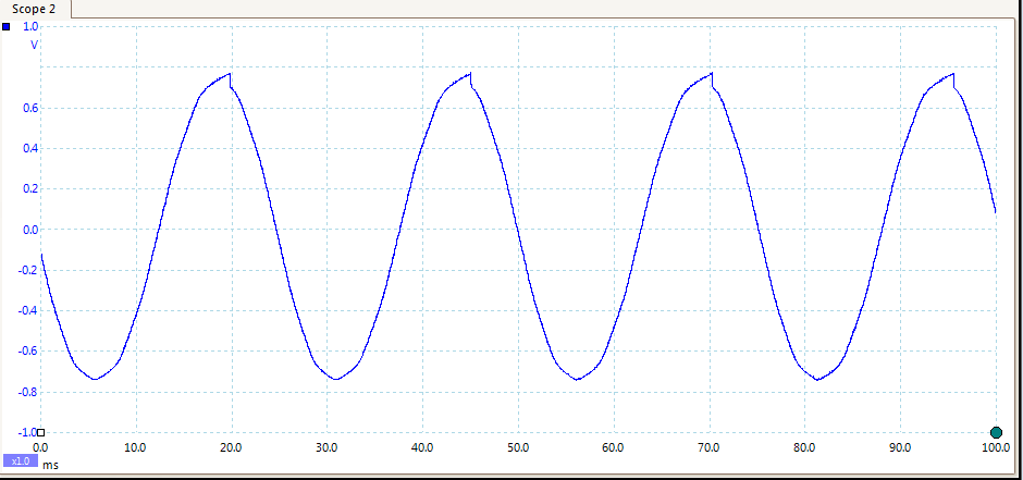

Hey everyone,
I was noticing some artifacts in my 901's sine wave- my scope shows the following.
(1) Is this normal behavior for a 901 and (2) if not, any thoughts on how to rectify (no pun intended :P ) it?

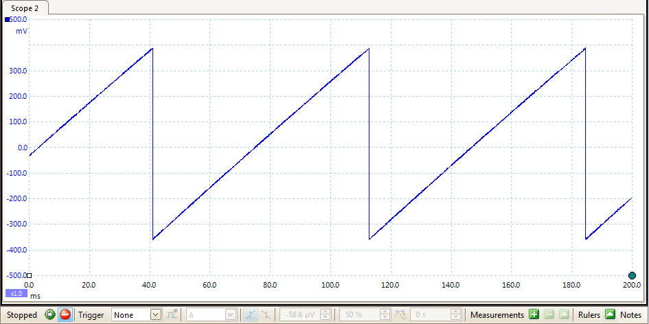

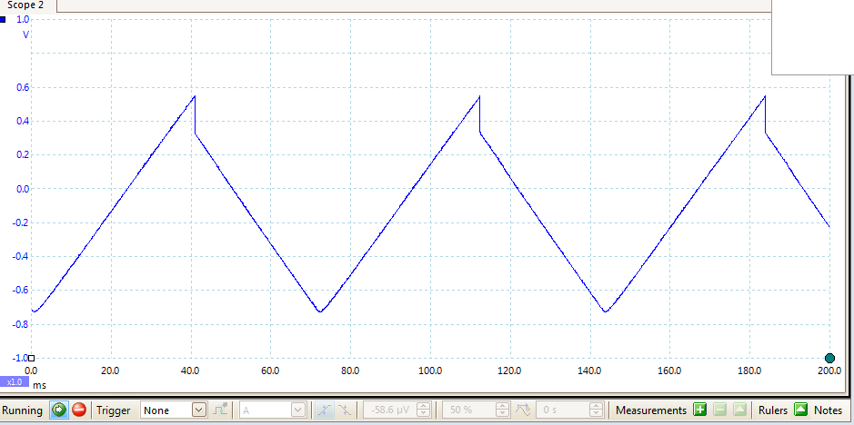

All the actual waveforms below:
https://soundcloud.com/m0rg/sinesawtripulse
Scope stuff is below; thoughts?

Post by Stevie Ray » Sun May 01, 2016 5:35 pm
On the 901 the sine is derived from the triangle wave which is in turn derived from the sawtooth wave.
The triangle is formed by inverting/mirroring one half of the sawtooth wave cycle.
From your scope trace, the triangle is not quite symmetrical - i.e. the circuit that inverts/mirrors the sawtooth is out of trim and is kicking in a little after the peak of the sawtooth instead of at the exact peak.
Look at the schematic and adjust the trim pot P3 and observe your scope for triangle symmetry. If that doesn't fix it, adjust trim pot P4 (sawtooth offset) also and then go back to adjusting P3. If that doesn't work, check the 1K resistors R8/R9 and replace if necessary to get the recommended 2.45V at Test Point 'A'.
