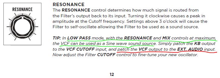

The manual says on page 12: The key thing I missed here and hope I got it now thanks to your explanation: if the MIX control is at maximum, the VCF output will only be fed with NOISE, however NOISE is muted if a cable is plugged into EXT.AUDIO, no matter if that cable receives any signal or not. But if the other end of that cable is plugged in an OUTPUT where no signal is, it will in fact mute the EXT.AUDIO, and that is the case here because of the NOISE being muted by the EXT.AUDIO and thus no signal at VCF output.

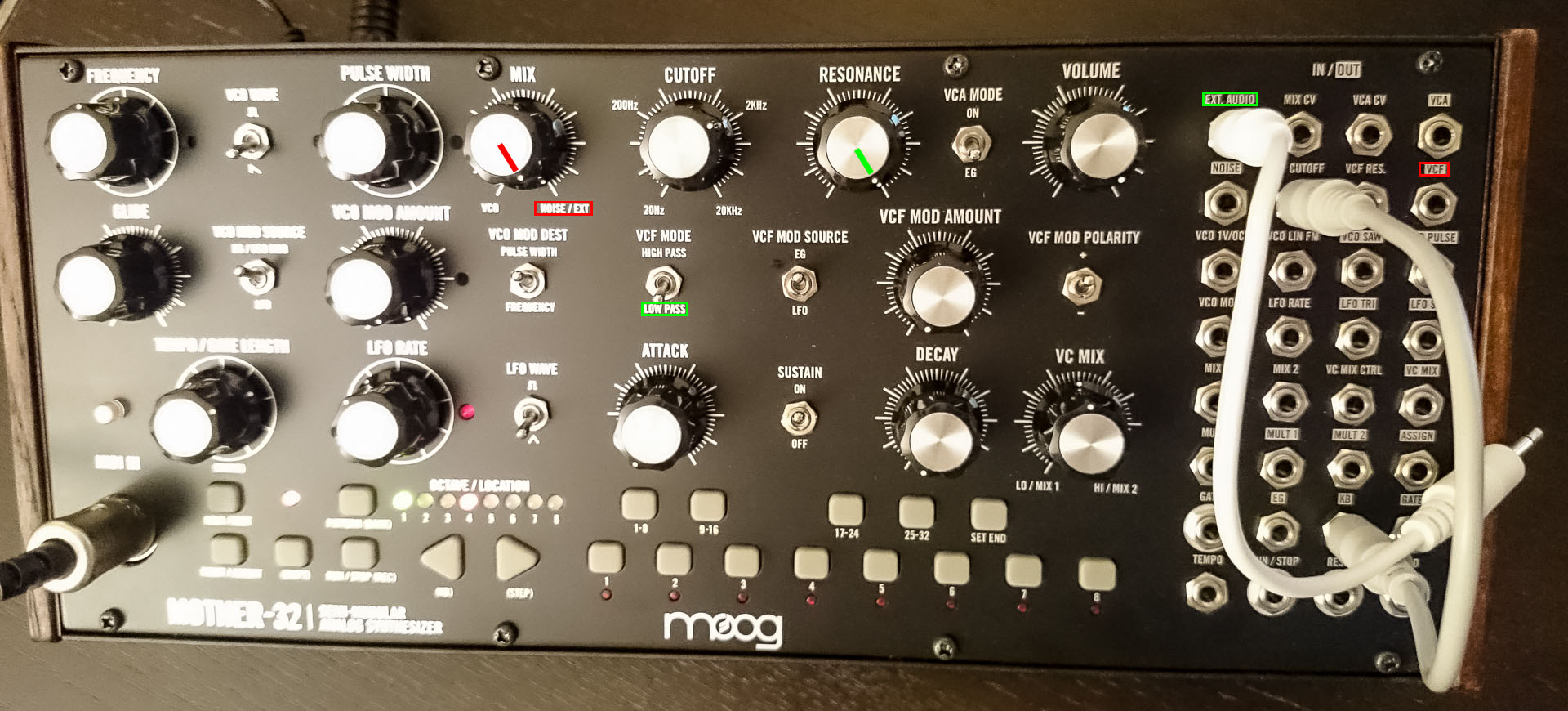

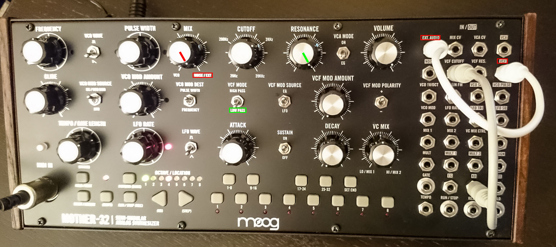

Here is how I patched it according to the manual, resulting in silence as just described: And here is how the Sine wave plays as it was probably intended (and works also without the KB to VCF Cutoff, then the pitch is only controlled by the cutoff itself without keyboard follow): So, that's all about the "magic" that I didn't seem to catch yesterday... at least I hope I got it right now
Here is how I patched it according to the manual, resulting in silence as just described: And here is how the Sine wave plays as it was probably intended (and works also without the KB to VCF Cutoff, then the pitch is only controlled by the cutoff itself without keyboard follow): So, that's all about the "magic" that I didn't seem to catch yesterday... at least I hope I got it right now![]()

Thank you jido-genshi! I Actually I had turned the Cutoff to this position because the sine wave was clearly audible WITHOUT the cable plugged in. Now today I tried it again with the settings you advised, and for a moment I really thought I got it, there was some weak signal audible. So I thought it must be something else... however the more I tried, the more the signal seemed to disappear. Disconnecting the one end of the patch cable from the VCF out again, and the Sine was clearly here.jido-genshi wrote:Plug that cable back in and turn down the Filter's Cutoff knob. And to be safe/to start at the basics, also turn down the LFO Rate and VCO MOD AMT knobs. Also, turn up the Decay knob and turn down that VC Mix knob. Now do you hear the sine wave from the Filter's Resonance?
So let me show this to you in a video, I guess this way it will be clearer what's going on. I'll upload the video as soon as it is ready in a follow-up post (hope this is okay).
