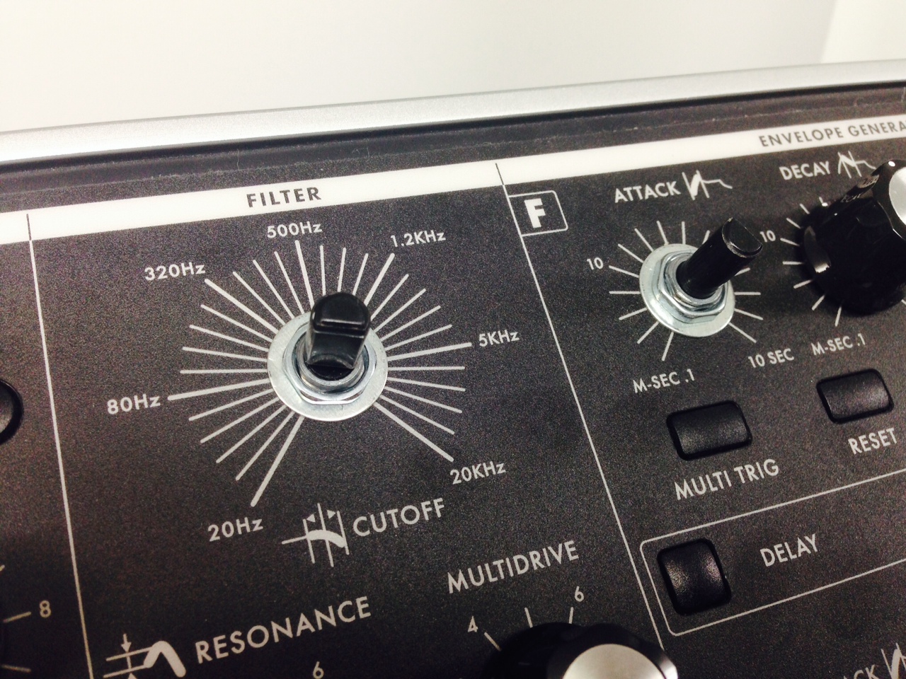

hi Sardino, this is a good question.
here is a pic of my Sub37 (SN...low 400)...filter knob, with the knob removed:
as you can see, the shaft is black plastic. all the shafts are black plastic.
i have a sneaking suspicion that the new "fixed" pot will have a metal shaft, as most traditional chassis-mounted pots have this. It makes them stronger.
if i am right, then it will be as simple as a user just having to pull of their filter knob to see if they have a plastic shaft underneath (faulty Sub37) or metal shaft (revised/fixed Sub37).
i will ask Markus to check on this. lets see what he says. if anyone else can shed a light on this also it would be appreciated, it may save a lot of people voiding their warranty by opening up their Sub37's just to check!

That's useful, and something I hadn't thought of. D'oh.Blackout wrote:here is a pic of my Sub37 (SN...low 400)...filter knob, with the knob removed:
Your filter pot looks (to me at least) identical to the attack pot. Hopefully someone with a very recent sub37 can post a similar photo showing how theirs looks.
It also shows that the mounting of the filter pot isn't "unusual" in any way which could contribute to the problem. I'm guessing, without any evidence to the contrary (my earlier post was ignored, it seems), that the old filter pot is the same as the rest of the pots on the board. This, I think, only really leaves two possibilities.
So, either the larger filter knob is the cause of the problem (causing stresses on the pot which the smaller knobs don't), or it's because the filter knob is adjusted more than the others. This seems to suggest the latter. That some people have had problems after only very little use suggests it's not just the amount of use that knob gets that makes it fail, so perhaps it's a combination of both factors. If it really is just down to that knob getting used more, then it means the other knobs/pots presumably would suffer the same problems sooner or later, and I don't think I've seen anyone report problems with other knobs (pot-related ones anyway). With the amount of use some units must have had by now, I guess the other pots are fine, and it really is down to the large knob.

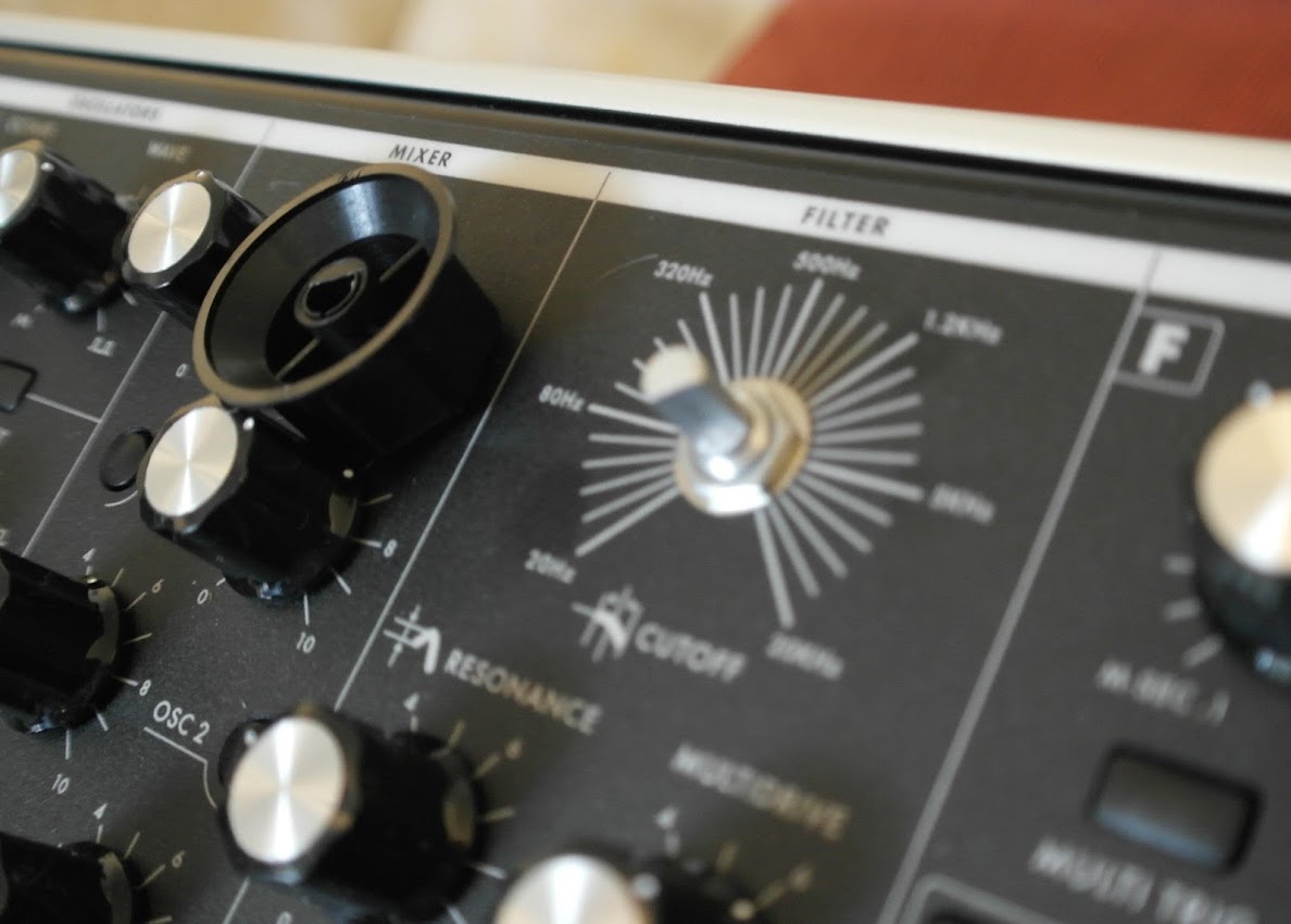

hi all, Markus has confirmed that his pot has a METAL shaft.
so the result of this is ...it will be easy to tell if you have a "faulty" Sub37 or a "revised/fixed" version. You simply lift the filter knob up and off. and look to see if the shaft below is a black plastic one or a metal shaft.
if it is a metal shaft, you have one of the "revised/fixed" Sub 37s.
