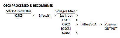

2. Processed Separately:
With OSC3 keyboard control switched ON, this configuration routes OSC3 through an effect before returning it to the Voyager via the External Input, where it is mixed with the other (unaffected) oscillators and noise source, and then gets processed through the Voyager Filter and VCA.

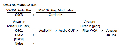

3. Modulator:
The ‘Modulator’ configuration uses OSC3 as the carrier signal for a Moogerfooger Ring Modulator. With OSC3 keyboard control switched ON, the ring modulator signal (with the MIX knob at max.) will track the keyboard, and the oscillator panel controls can be used to create a wide range of tonal effects, all playable in tune. Tubular bells, anyone?
