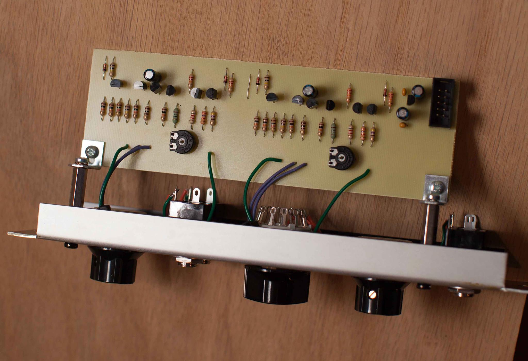

noddyspuncture
Posts: 468
Re: Please explain the 911a
Post by noddyspuncture » Fri Mar 06, 2015 8:41 pm
Hi Eric,
I bought my R.A.Moog system with all sorts of modules.... some of them complete, unidentified mysteries...!
It also came with a DualTrigger Delay...albeit only a front panel with no actual circuitry.
So I decided to build my own... and put it inside the 911A case.
i built it because I found out I really needed one... as I play in an ELP tribute band.
And ELP's "Toccata" uses the module exclusively for the lead synth patch. Check it out on YouTube... :D
That is the what this module does.. it delays the effect of a trigger. But you do need to hold the note until it takes effect.
ELP's "Toccata" should clarify.
Tom
