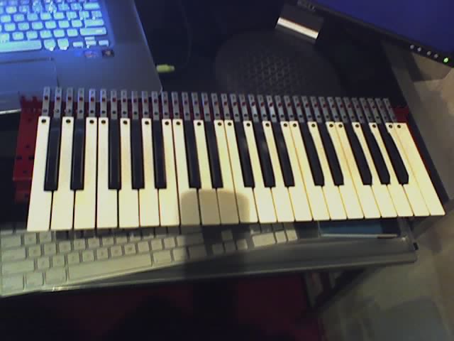

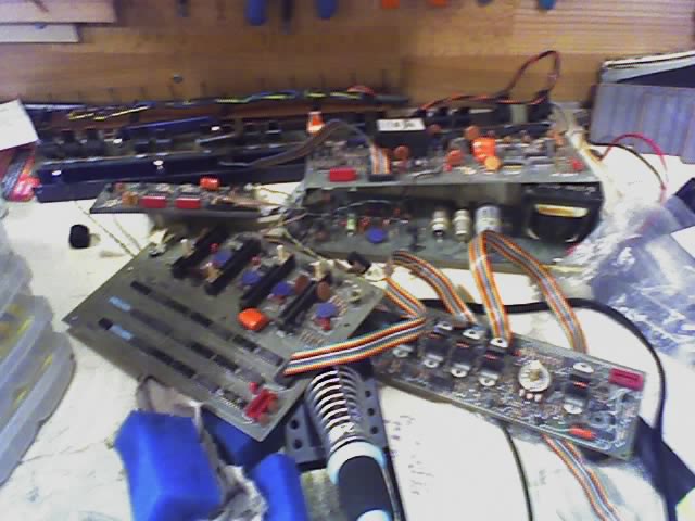

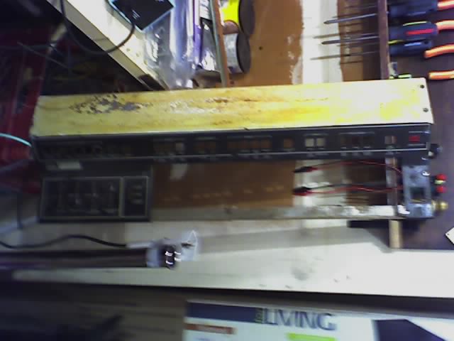

Check out this Pro Soloist...
Believe it or not, it actually functioned, although it needed a lot of work.
I actually started to refurb it; did the keyboard, but kind of got discouraged every time I walked by the case...

Hey Synthguy, seems that Arp has been out in the rain! Hope you get her back to normal soon!
My Arp is a bit scratched on top and some of the rocker switches have snapped but all in all she is in pretty good shape!
What I am realising is that those connectors are corroding because some of the background noise has come back.. but at least I know what to do now... thanks again!
