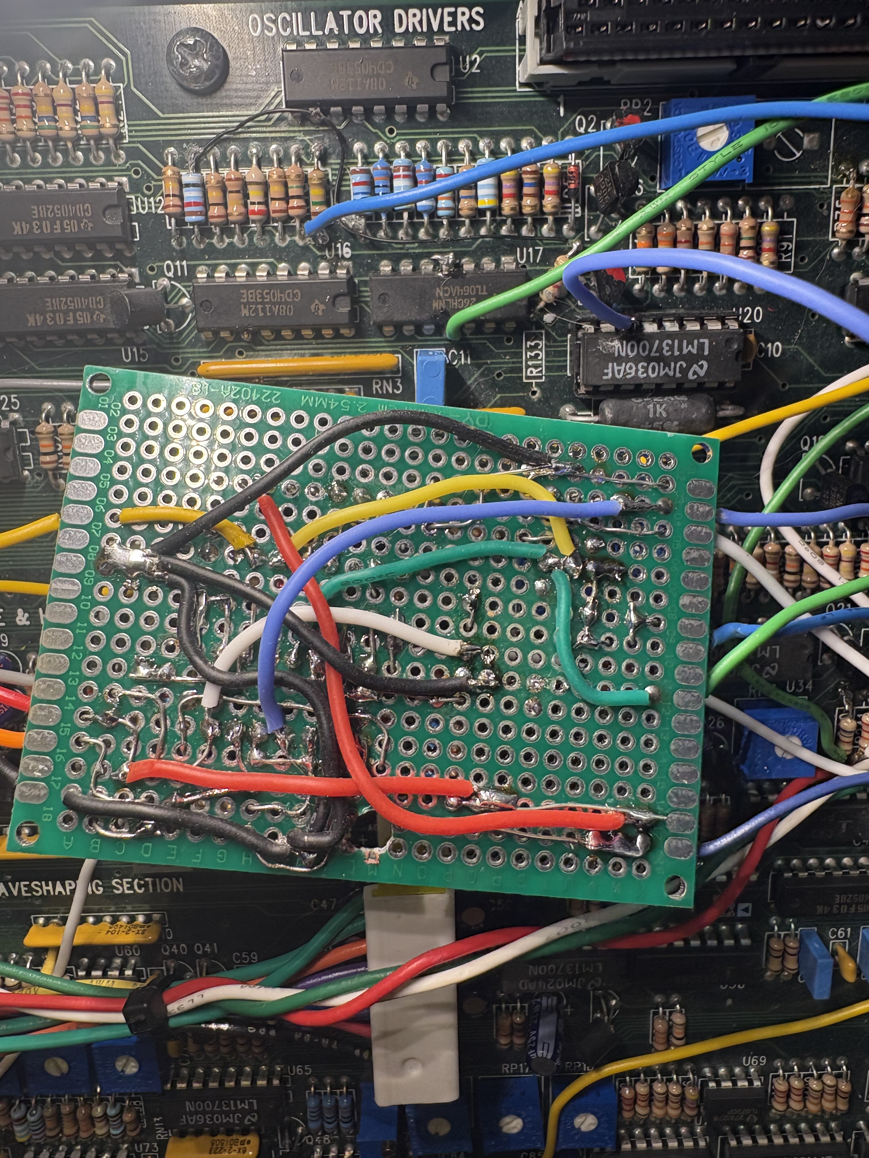

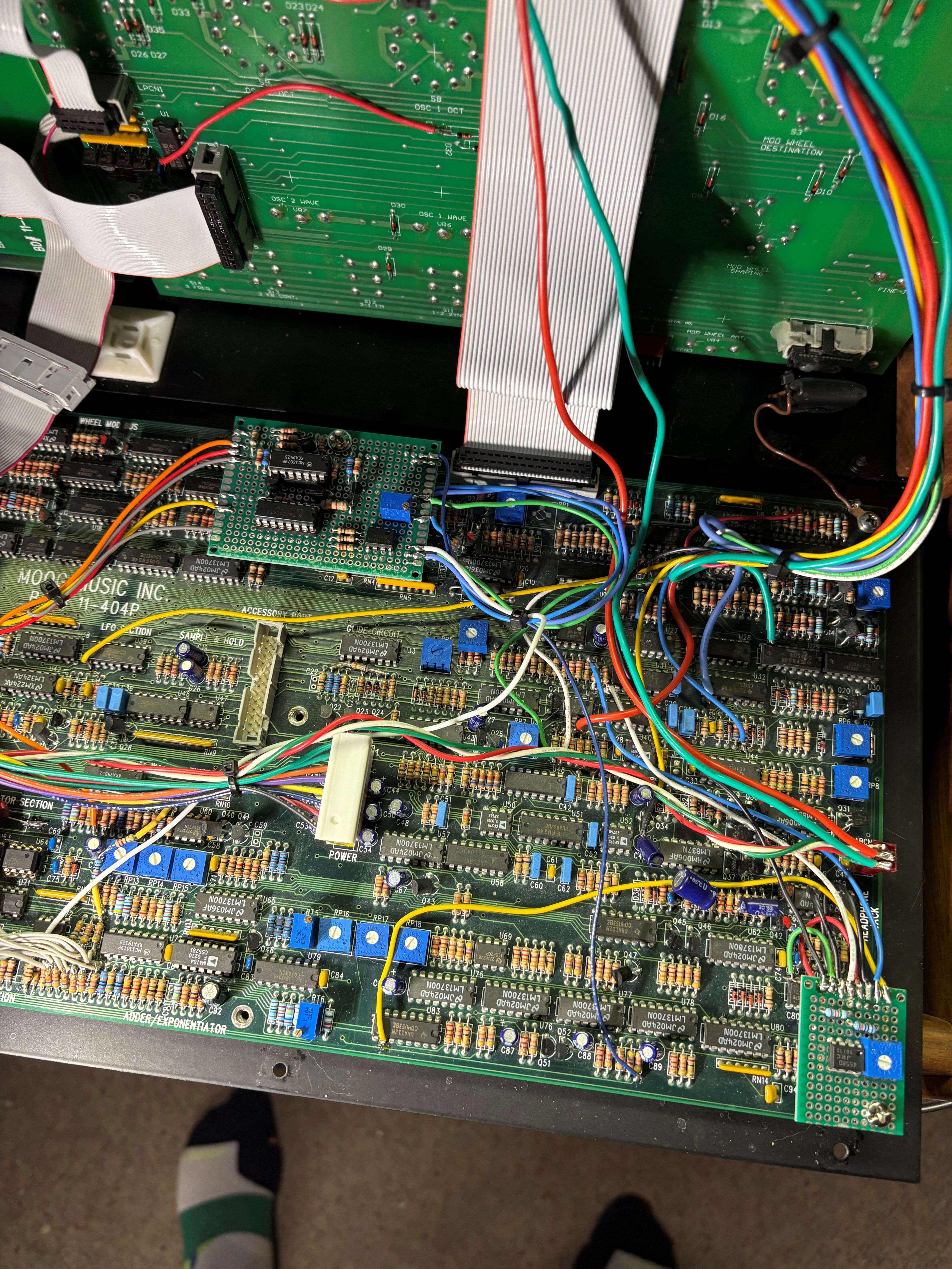

After 23 + years this mod makes that useless FM switch taking up valuable front panel real state useful. The stock Voyager (yours) FM switch brings a new type of FM.; Linear? Exponential? No… it’s Bilevel FM - on or off. And it sounds like CRAP! No control over the VCO3 modulator which is half the FM equation. WTF? Of course you can achieve FM through one or both of the mod buses which sounds great, but why should you have to?

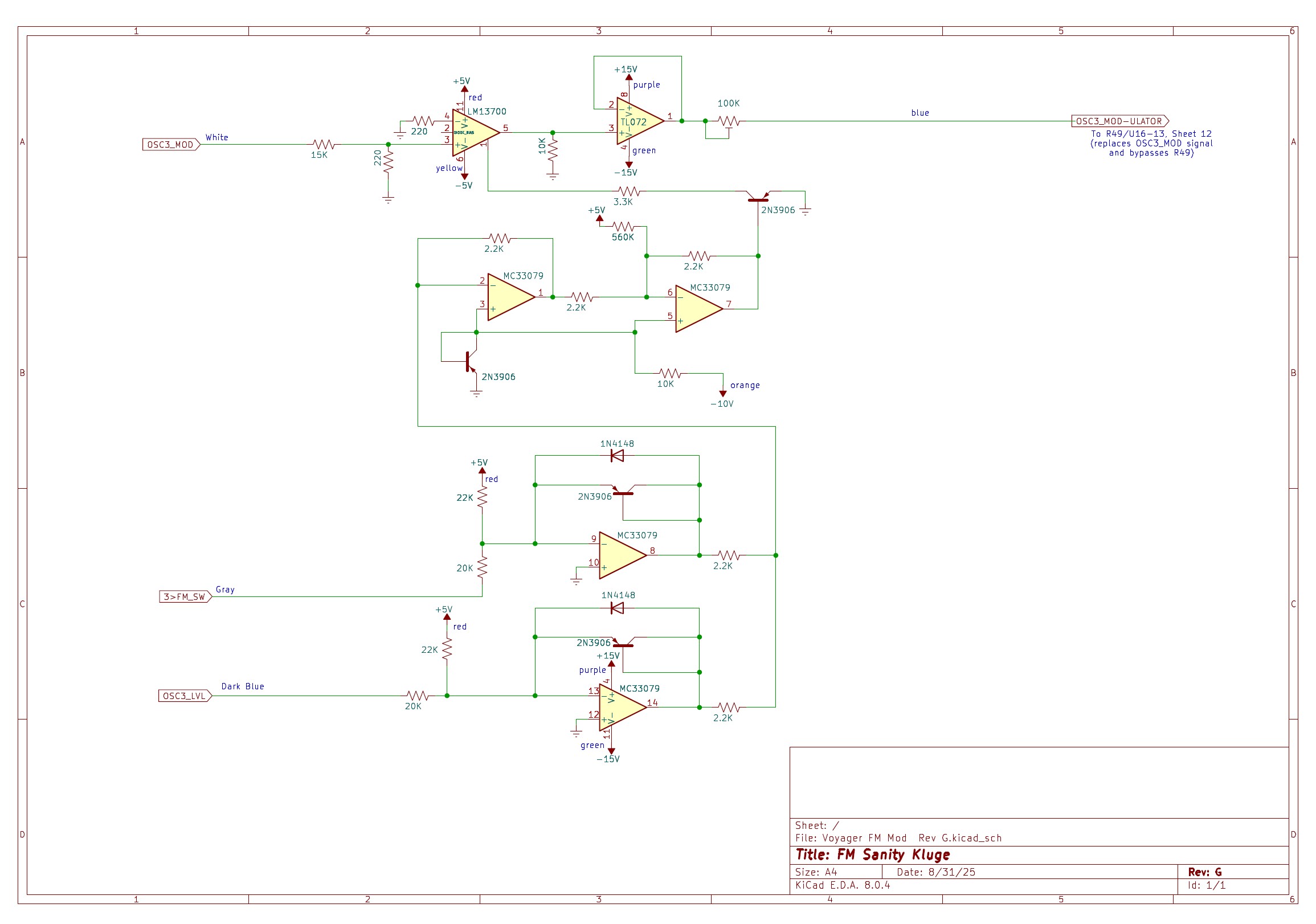

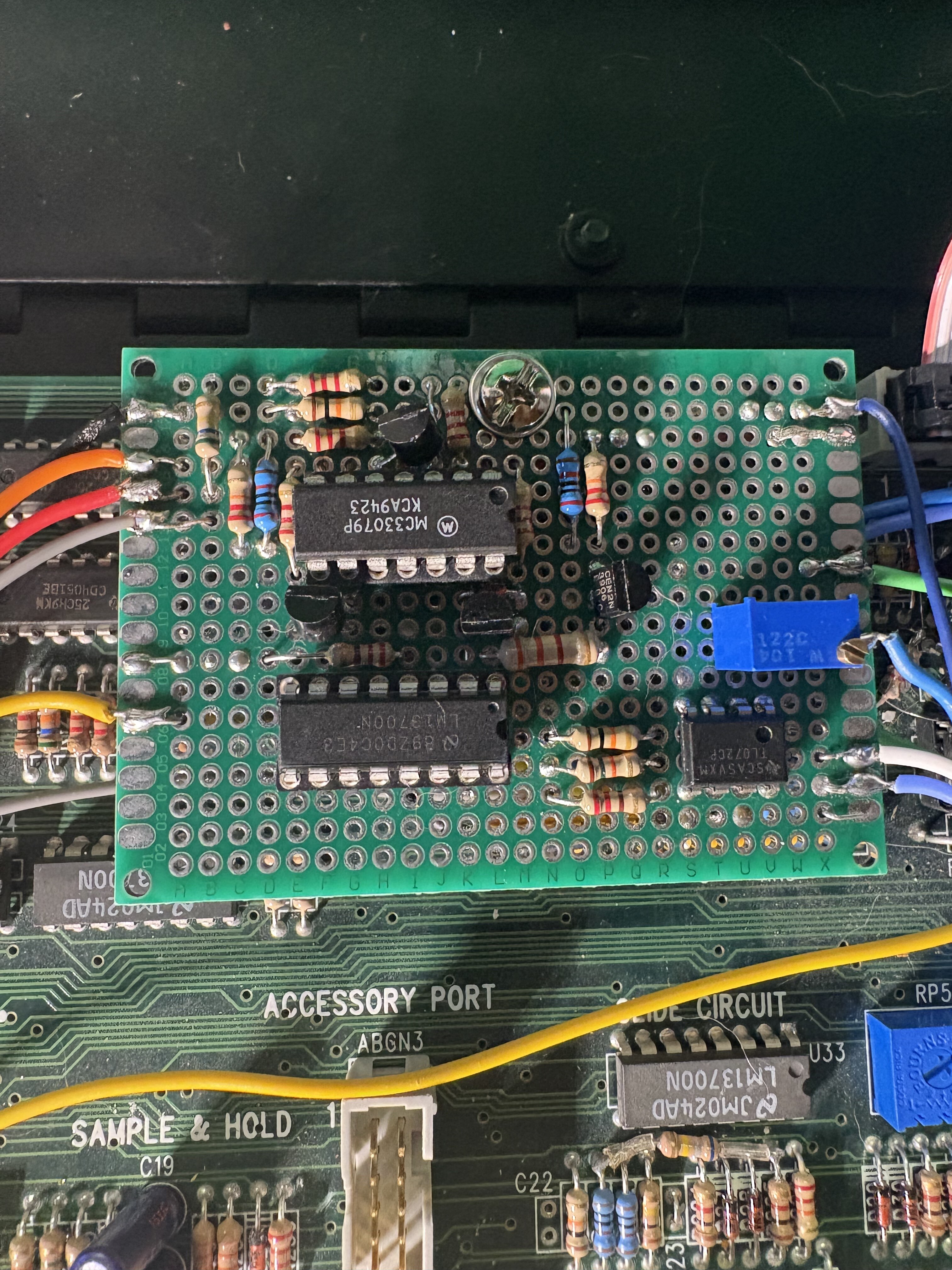

This mod duplicates either mod bus driver circuit with a few modifications of its own. It uses the VCO3 level knob/pot to control the amount of modulation. And unlike the original, pot mapping can be used to bring in FM via after touch, velocity etc. After several failed attempts using less parts it’s simple, and no drilling into your precious trophy synth front panel.
Happy to share this circuit since it’s really Moog’s circuit duplicated and repurposed:
