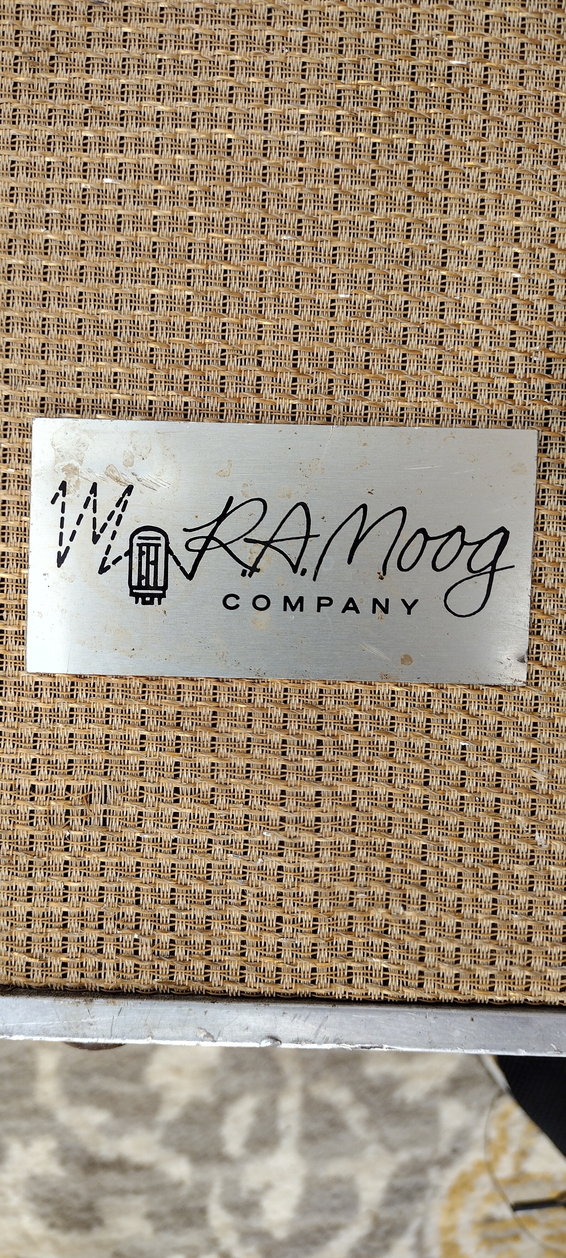

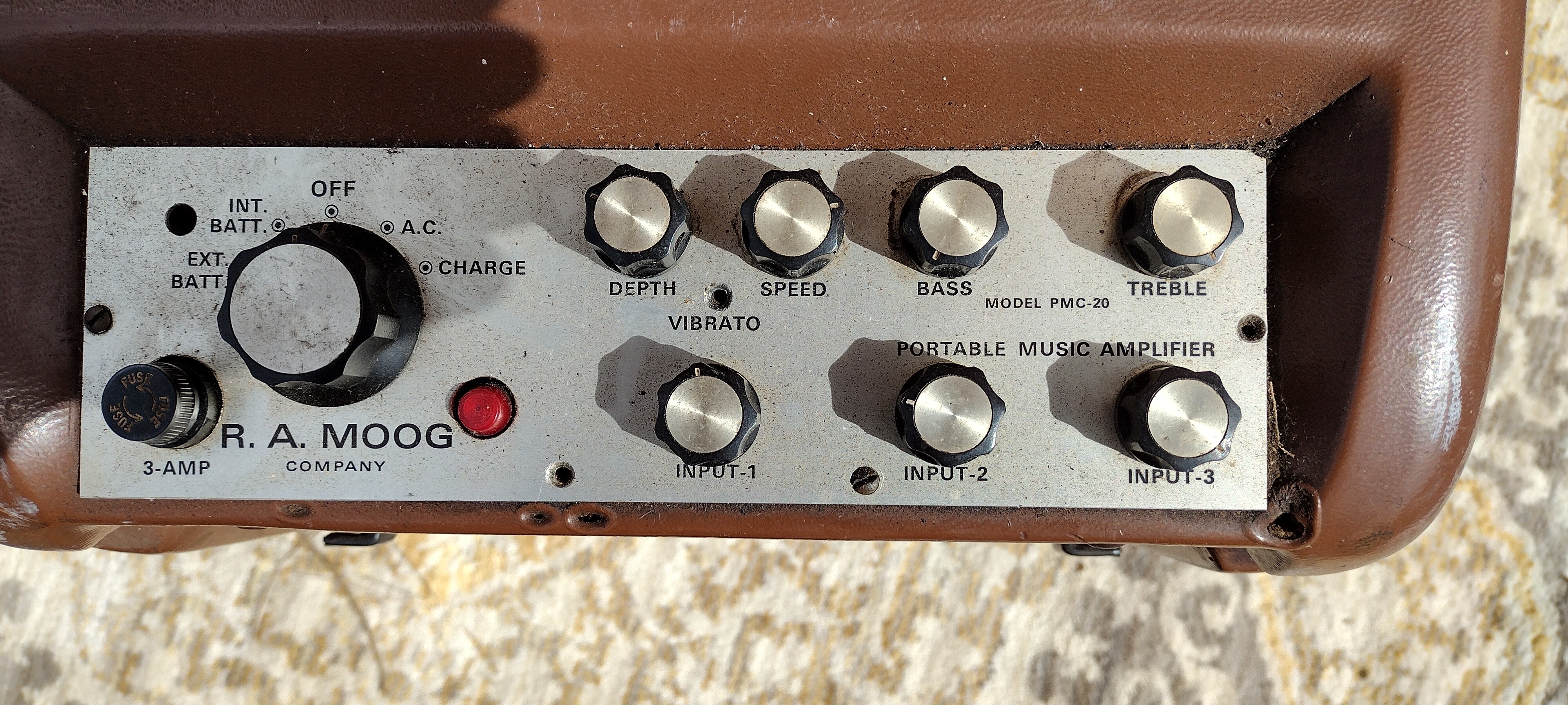

Hey hey everyone! I have become the owner of a R. A. Moog PMC-20 Portable Amplifier Speaker, but I know absolutely nothing about it! Can anyone enlighten me a bit? I’m curious to know how it works, how rare it may be, and (of course) some general idea of what it is worth. I will attach a few pictures of it to this thread. Any and all information is appreciated and welcomed! Thank you!

It appears to have a rechargeable battery inside, I would check that to make sure it’s not leaking, and maybe replace it with a new one?
Otherwise you could probably remove it & use the amp just with an A/C cord, or external batteries as the panel indicates?
Also wise to replace any old capacitors in the power supply.

That is nice, and the badge is so cool-looking! If you wish to have it restored, Jareth Lackey, SynthPro, is a great option. Look up his youtube videos.

Wow! It looks quite nice :smiley: . Have you tried to use an A/C on it, or are you just using its external batteries?
