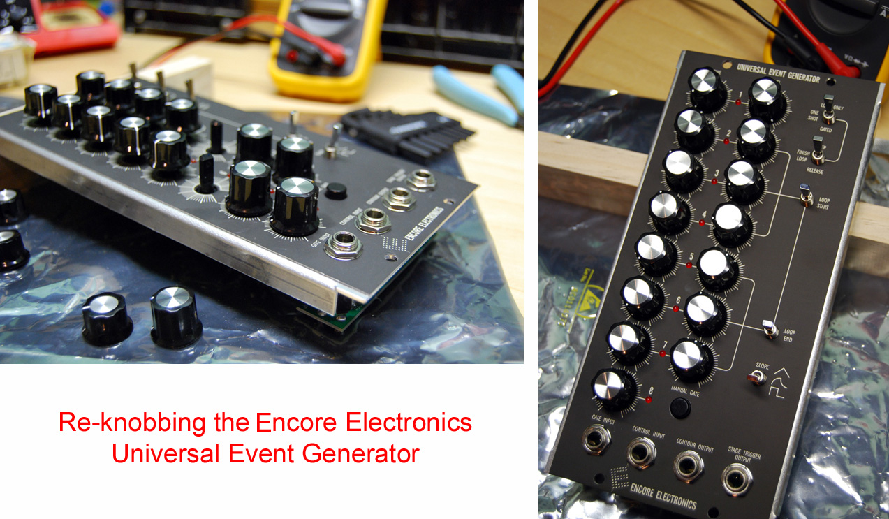

I’ve used both types for some recent re-knobbing projects:
On a modular panel:

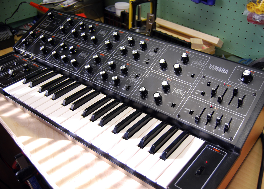

On a vintage synth:
EDIT - I believe these are the same knobs that Moog uses on the M32 and Sub 37.

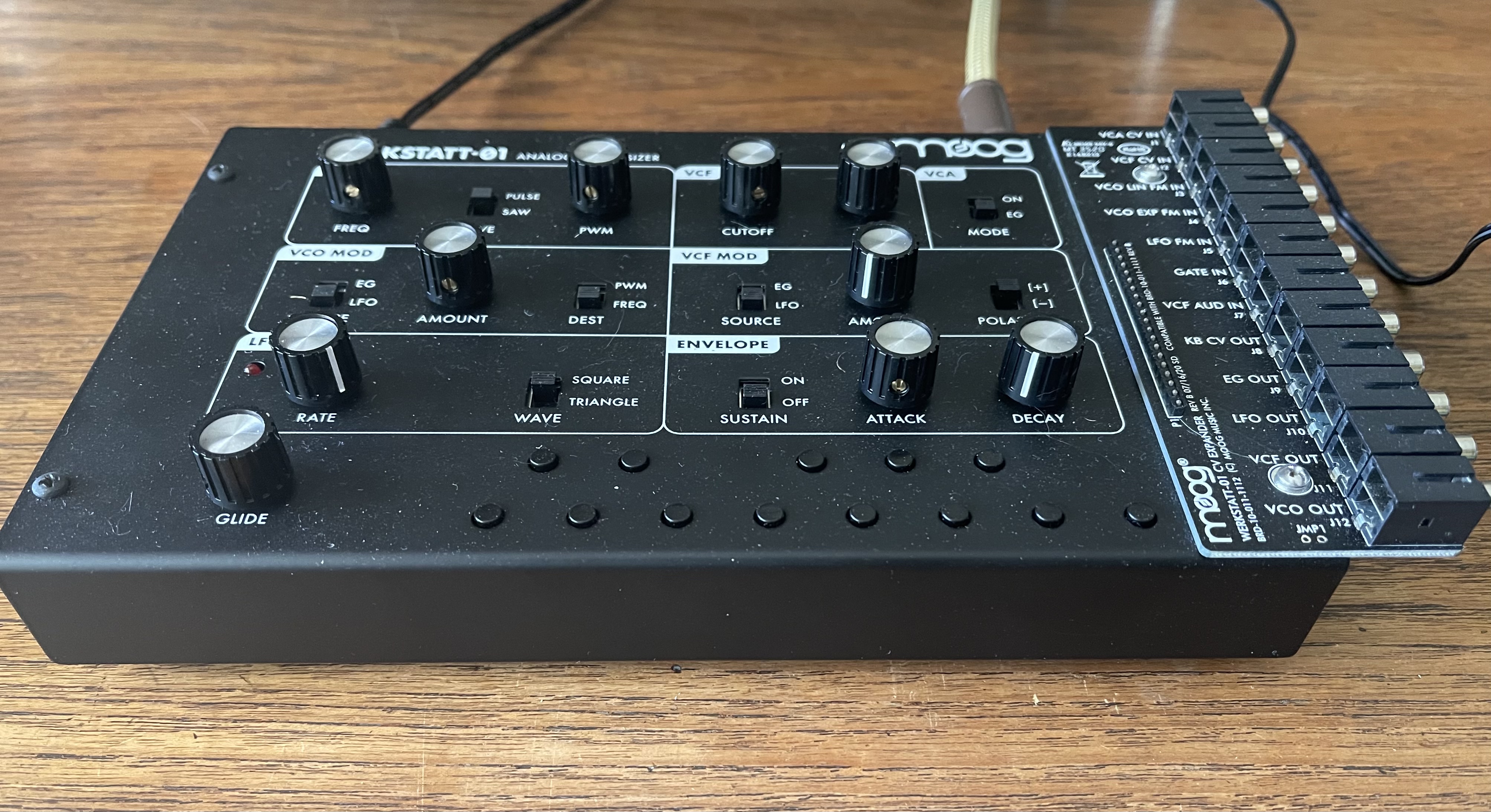

I got my knobs through THONK in UK - they work fine and don’t cover up the lettering - here’s the spec:
They need to be quite small (6.35mm Round Shaft) - mine are 1900h Plastic Knob
https://www.thonk.co.uk/product-category/diy-accessories/knobs/1900h/
In a range of colours too! - not sure which should be the white and black
