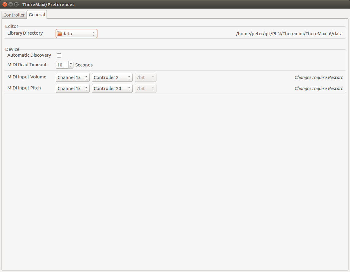

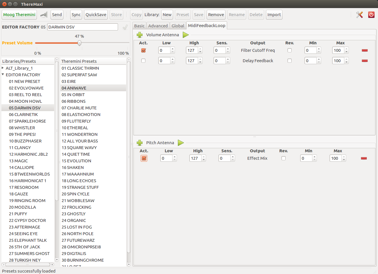

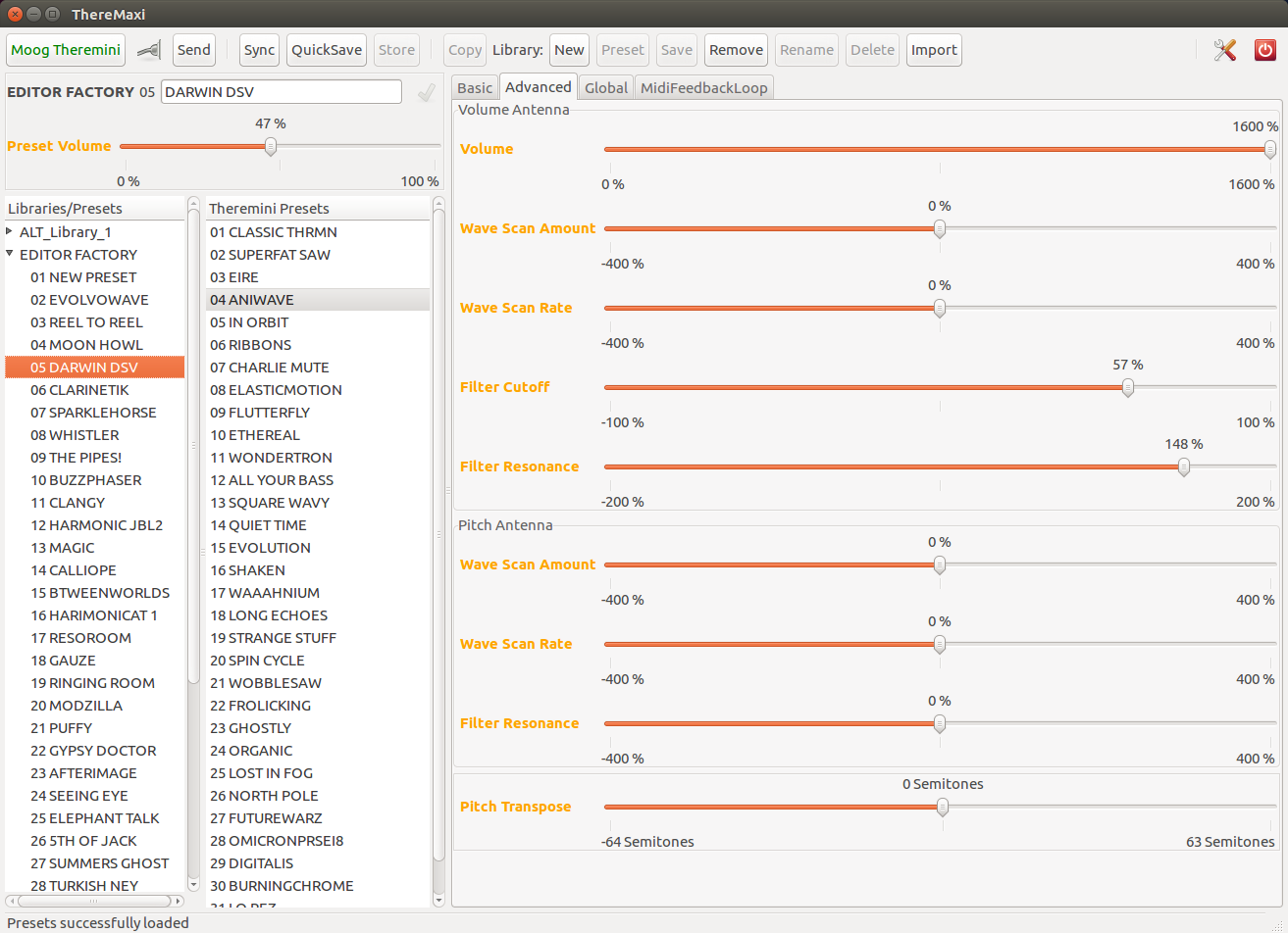

Screenshots of main functions
Screenshost of additional feature and preferences
Thanks, this looks great!
We are sharing this with our customers and hopefully we can test it at our showroom (there are some computers running that OS here)
