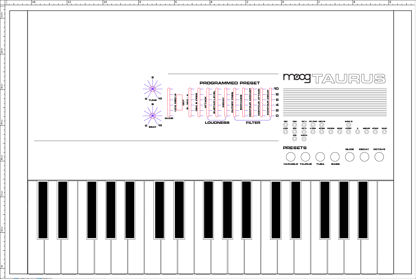

hello! i am modding out a taurus 1 (converting it to a 3 octave keyboard, midi, and adding patch points for modulation from a modular). curious if anyone has mapped out all the accessory patch points that the un-used pin connectors connect to and their ranges?

thanks for getting back to me! looks like i am going to have to do a bit of guess and check. the schems at least give an idea of what goes where.
