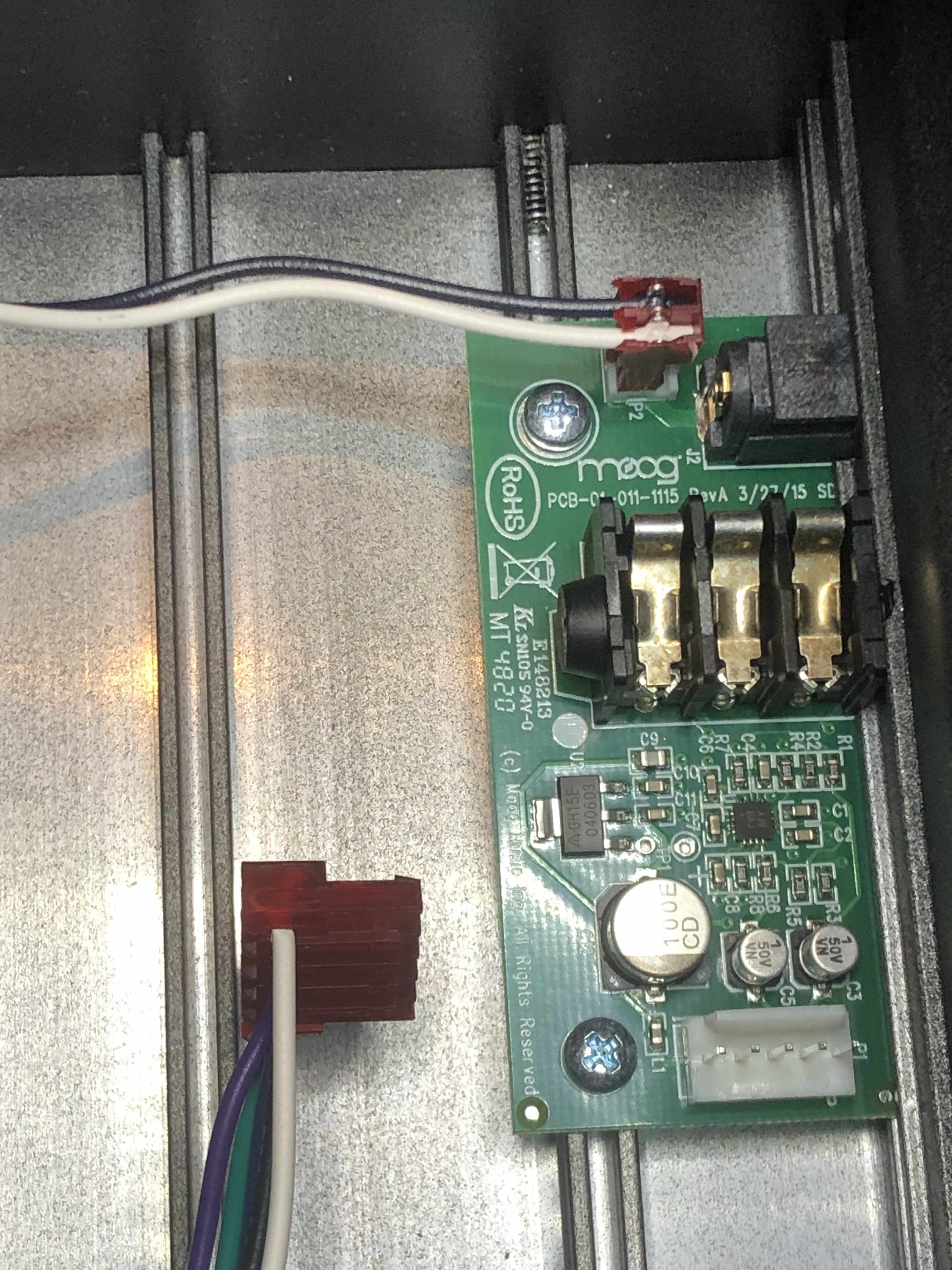

My Subharmonicon suddenly stopped working from one day to the next. Upon powering up, only LED 1 of Sequencer 1 is blinking erratically, and the unit becomes unresponsive. I tried a firmware update, but it doesn’t recognize any incoming messages.
After opening the unit and doing some troubleshooting with a multimeter, I discovered that the issue is being caused by the audio output board. When I disconnect the output board, the Subharmonicon powers up correctly and responds as expected.

The VCA output follows the volume control, so you can dial the volume down to optimum audio interface input levels.
Yes, it should be safe to use the VCA output directly into your audio interface while waiting for a solution. The VCA output provides a clean signal that is typically used for routing the audio to external gear. bạn có thấy điều này hợp lý?
