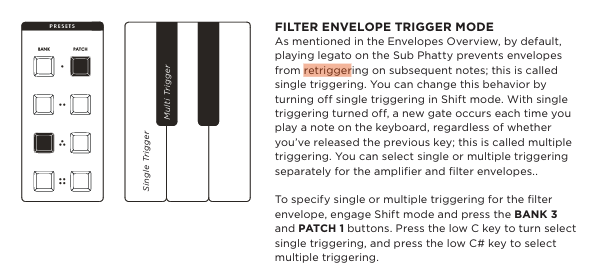

hi Grailtone, no, turning the glide knob all the way down just makes the slide from the previous key to the next key zero time. but the attack on the next key is gone. so instead of my nice big fat moog attack on my bass sound all i hear is a sub tone with the filter down on the next note…because the filter envelope has not retriggered.
and turning off Legato Glide doesnt seem to make a difference to this problem.
i just want to be able to play staccato notes and hear all my filter attacks! what the hell!!
I know this is 12 years old and you probs don’t need help anymore, but for anyone else stumbling across this issue as I just did - this fixed it:
