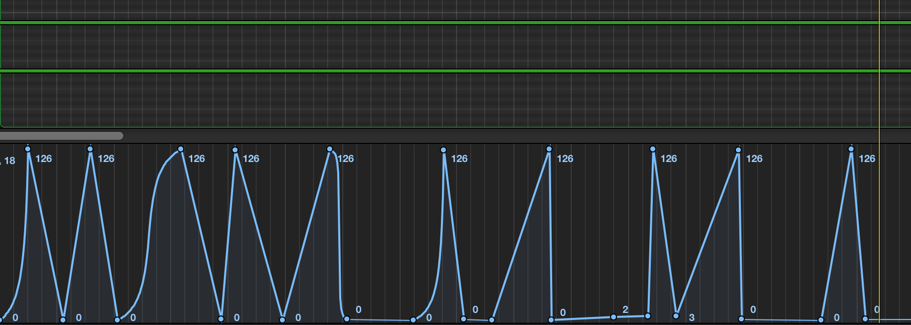

Hi guys, I’ve done two recordings of the issue that I’m having with the Multidrive knob.
Just to explain what’s happening - when I twist the Multridrive either physically or automate it by MIDI, I get that noise which I’m not sure if should be there and I’m a little bit annoyed with it. Listen carefully to the noise when the amplitude increases and decreases. I understand the signal goes through the distortion path, but is that noise supposed to be there?

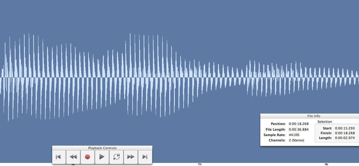

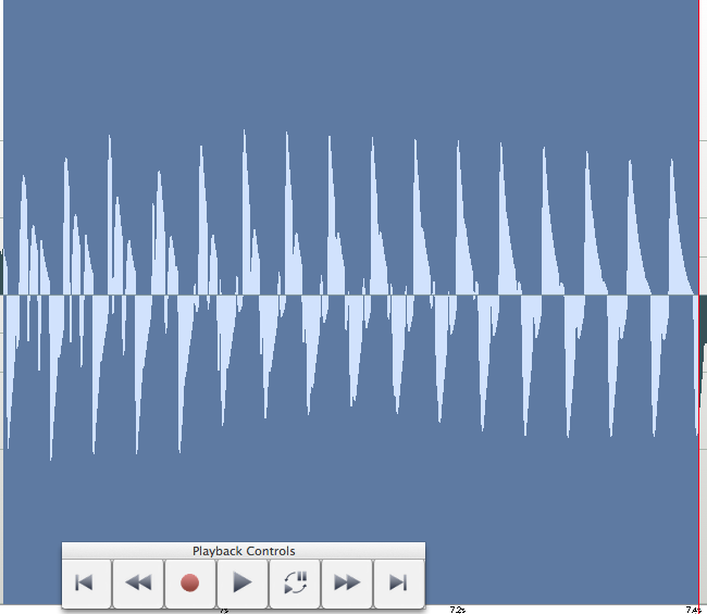

I have tried a variety of patches turning the multidrive up and down and hear no issues at all. Grabbing a bit of your sound cloud sample and looking at it in ‘Wavepad’ you can see little ‘spikes’ which I think is the noise you are talking about. Are you recording directly from the Sub37?
