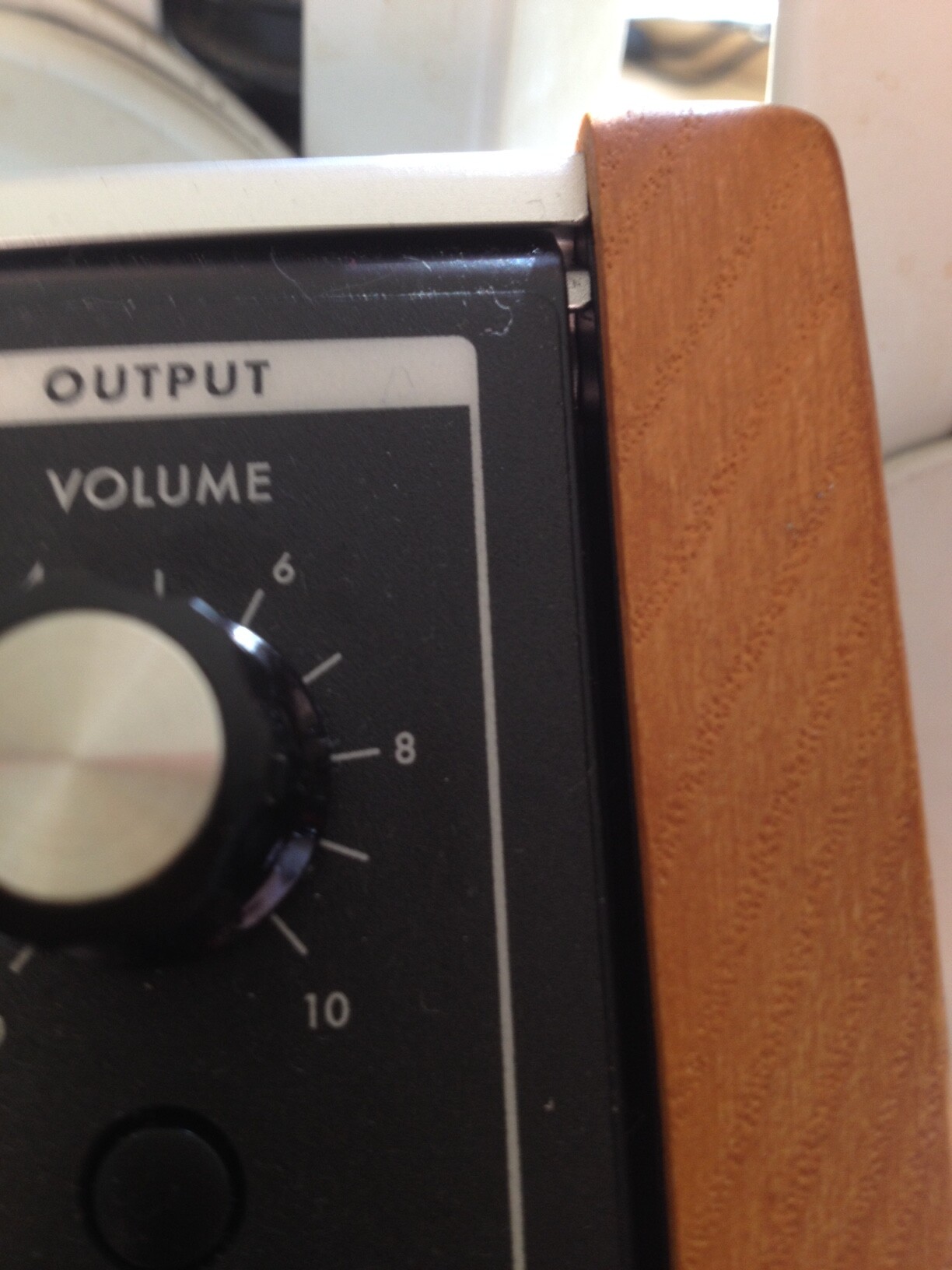

Hi, I have noticed a gap between the left side of the main panel and the wooden side piece.(See Attachment)
is this normal?

That ‘detail’ has been noted several times already here, more often noticed on the left side, because of the mentioned backlit screen that leaks sometimes a bit of light.
This is due to the fact that the aluminium extruded back is cut maybe one millimeter longer than the front panel and other parts (bottom plate…). I must say I noticed it only because I read about it here. I think Moog distributes some kind of foam sticker to block light coming out for those too heavily blinded (gentle pun here).

By the way, Moog is correct it can be adjusted out – you don’t need to take the side panel off just loosen the top center bolt slightly on the ‘tight’ side, and tighten the equivalent bolt on the other side and it will pull the panel to even out that gap – then you definitely wont notice it. The panel simply slides side to side – I imagine those with the gap n the left had their Sub assembled right side first, those on the right opposite!

Looking closely at my Sub 37, the woodwork on the end cheeks looks less than top-notch workmanship, and I suspect that’s where the problem lies.
Without taking my Sub 37 apart, I suspect the end cheeks have machined rebates (grooves) to accommodate the panels and frame, and that these are not machined deep enough to fully close up the panel to the end cheeks.
