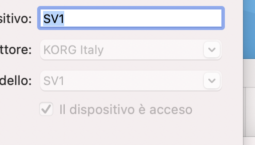

My Macbook air M1 Big Sur recognize all my external usb/midi devices (Korg SV1 keyboard; Waldorf Blofeld synth; Behringer umc1820 audio interface; Akai APC40 controler; Midistart music 25 midi keyboard) except Moog Slim Phatty! No one of these devices needed an update to be recognized by the computer.
SF is recognized in the Midi Configuration window but it appears like not turned on. In all the other devices is selected “on” automatically. There’s no way to select “on”. I tried with another macbook m1 Big Sur and was the same. With my old macbook pro (intel i7, OS 10.13.6) everything works fine.
