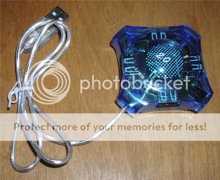

BTW -
You can plug a generic powered USB Hub into the iConnect MIDI, and it can then link and power several USB-MIDI devices simultaneously, as well as multiple other MIDI DIN, iOS, and computer hardware devices.
