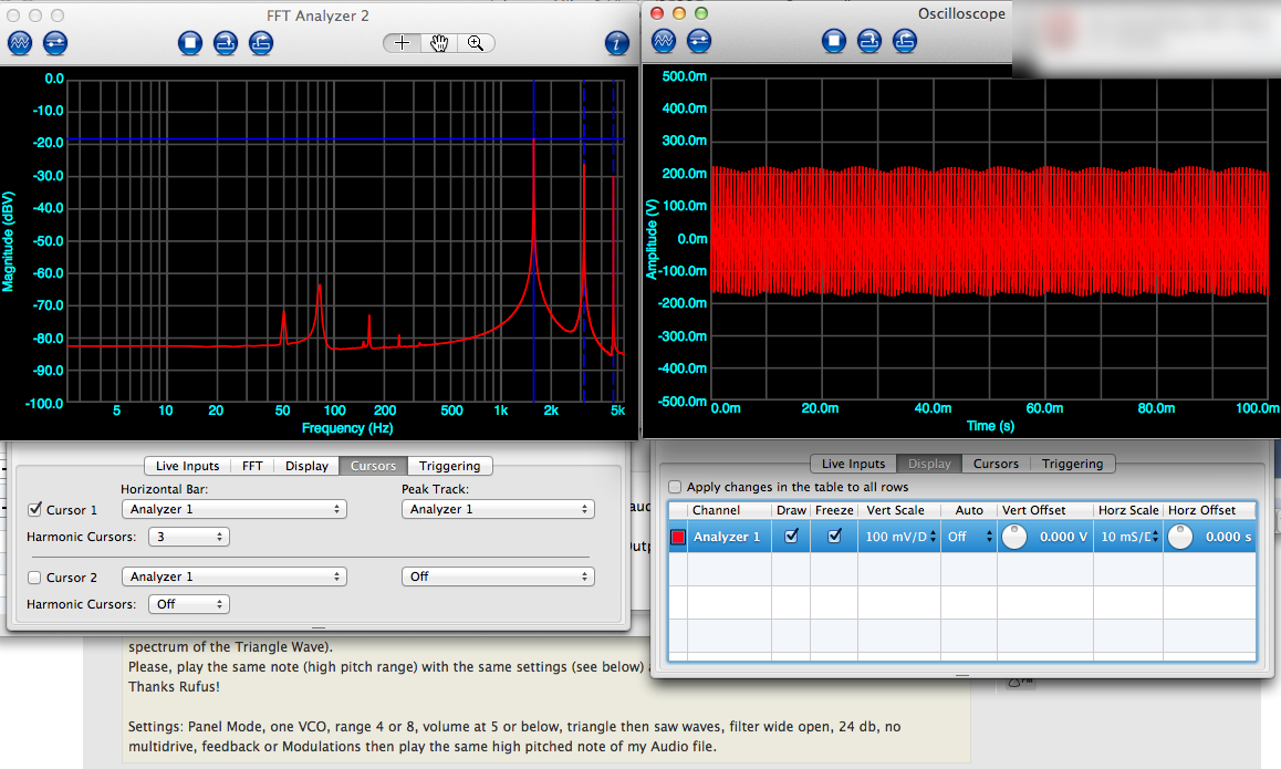

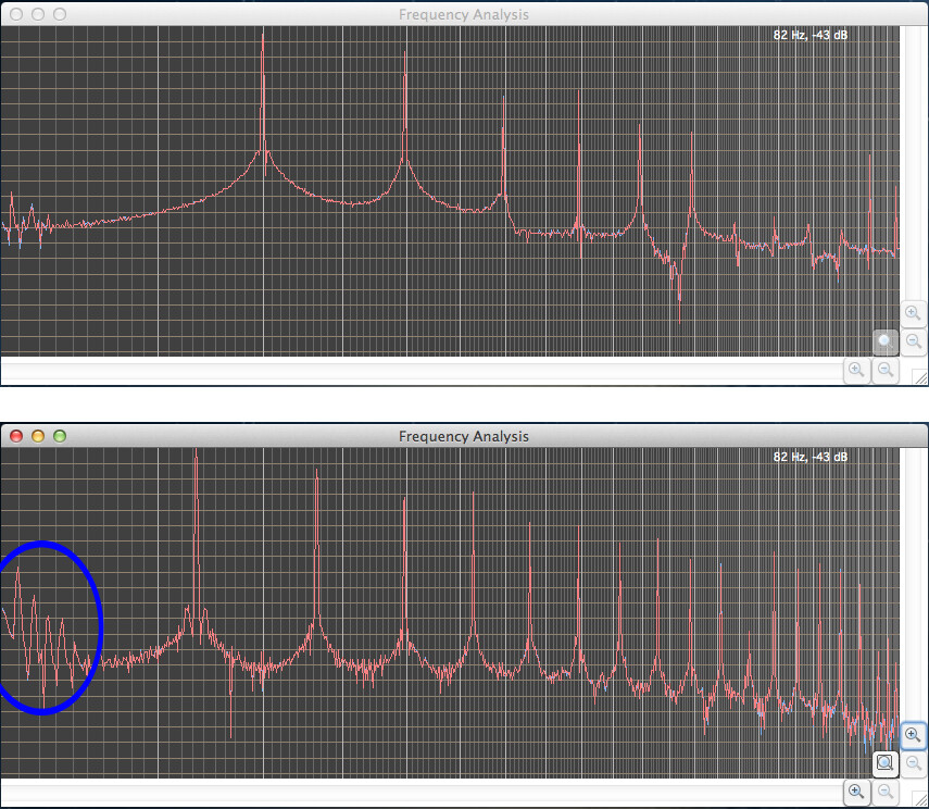

Ok, so I have been running a few tests. I recorded a constant G6 whilst slowly turning the shape knob from triangle to sawtooth.
Have a listen https://dl.dropboxusercontent.com/u/48045856/Sub37%20Serial%20Number%201221.wav and see if you can hear anything
I then used some analysis software called ‘SignalScope’ to look at shape and frequency spectrum. I need to edit the images together and post in a bit but the upshot is that I also have a constant 82Hz tone regardless of note played. It is a lot lower than the note level but it is there.
I also noted that the 82Hz ‘modulation’ of the note waveform was worse about the third index line clockwise on the shape knob.
I’ll add one image here ….

Many thanks for this! Unfortunately for you too, there’s a constant low drone note in the spectrum of the vco (between Square and Triangle), Bingo! Though not as loud as mine, it’s present. The polish seller and i are right, it’s not only an issue only with my unit (now returned) but a “feature” :open_mouth:

All credit to gencomprodukts for first posting about the effect but it seems, without doubt, it is a design issue. Even if I cannot hear it too clearly that may be entirely due to what I am listening with and ears :smiley: … the FFTs I ran on both gencomprodukts samples and my own Sub37 (Serial No. 1221) display an 82Hz signal and harmonics.
Given that the frequency of the ‘drone/buzz/hum’ does not move with note value would suggest it does not originate in the VCOs themselves, and I cannot see where in the Analogue chain such a fixed frequency spike would originate. That leads me to suspect digit aspects of the Sub37, for example is the led back light or display ‘strobed’ in anyway?
