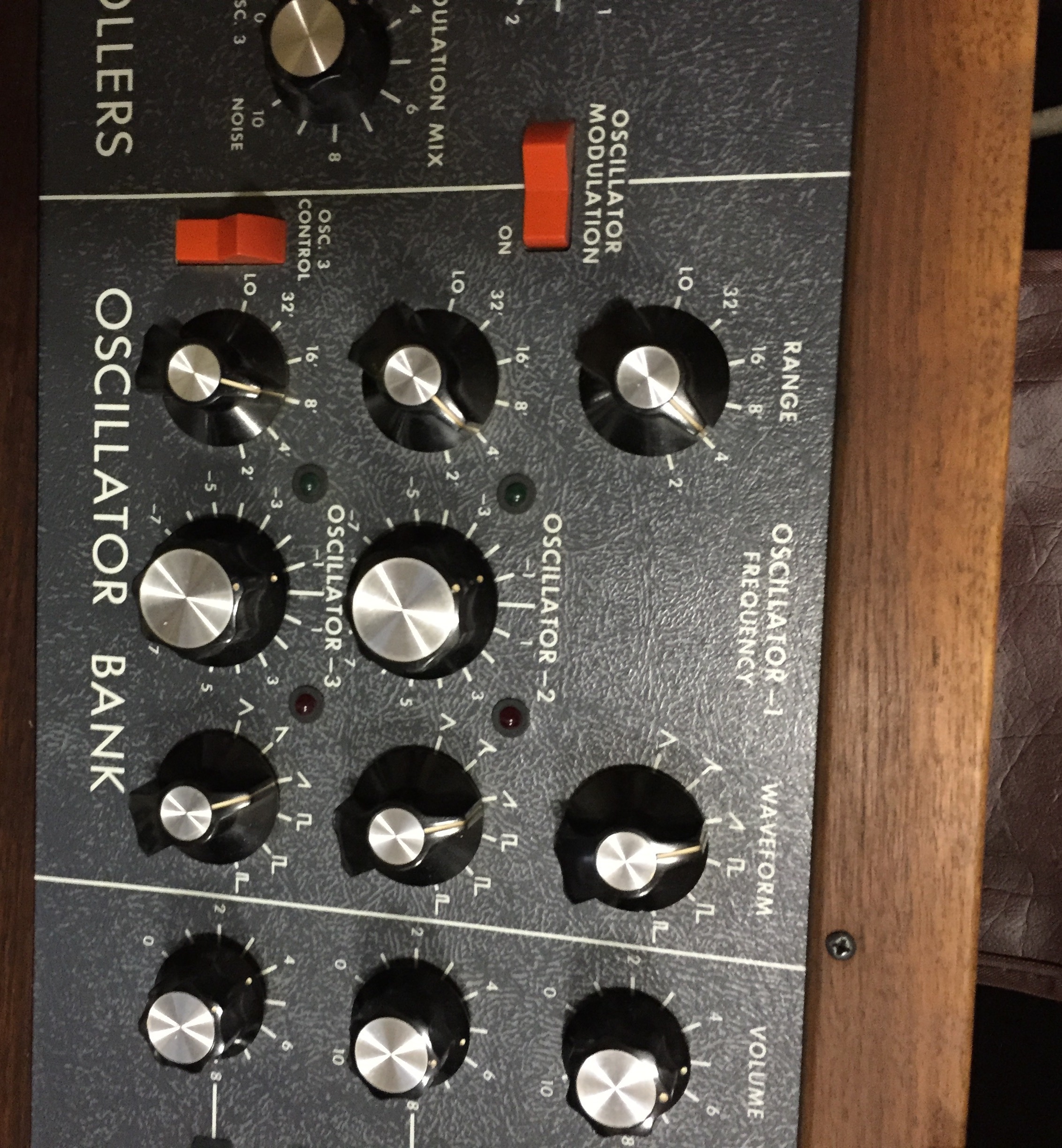

I attached a picture of the tuning LED’s I still have on my minimoogs. There’s also a pair above the Tune knob which syncs to the 440osc.
