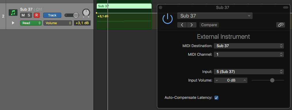

You have to set up a Software instrument track in Logic that uses the External instrument plugin, and then set up the External instrument MIDI port and channel to your Sub 37, and the returning Audio c port for the audio.
When you select the track in logic, with Local off on your Sub 37, playing the keyboard now sends MIDI not on-off to Logic and Logic sends the notes to your Sub 37, which in turn will send its audio to the audio port you set up in logic.
Got some screenshots attached, in reverse order (sorry)

Thanks…
I don’t know why the first time I disconnected local the keyboard stopped inputting Midi , however I went back , tried it again, and it worked …Thank you…
