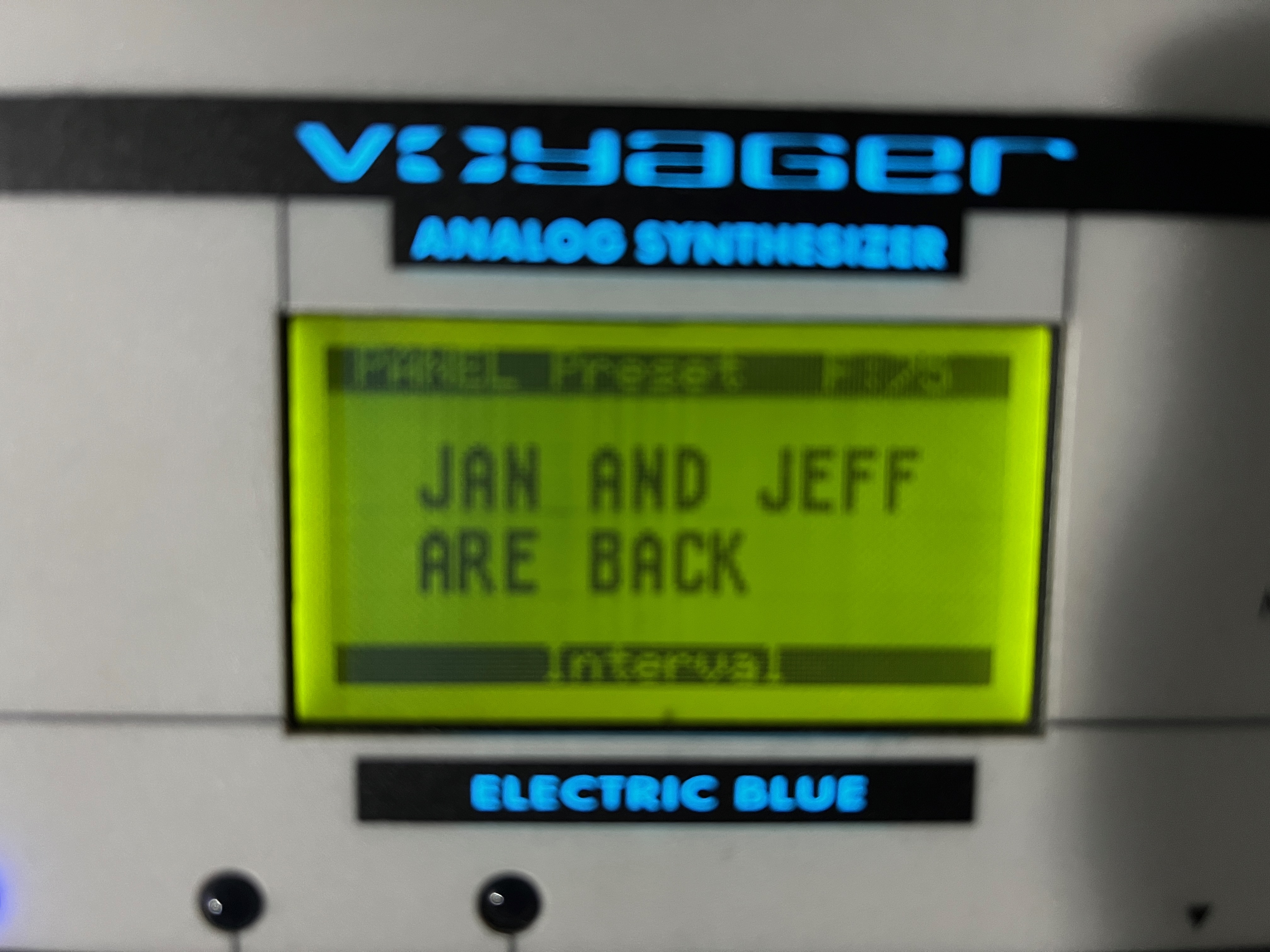

I’m having an issue with my Moog Voyager (v3.4).
It keeps rebooting endlessly—see the video (https://drive.google.com/file/d/1f7bhkq5ZWzlcO1Jk4D0OVWh9TmzwdCva/view).
I tried installing v3.6 and deleting all my presets, but the problem persists.
Help!
Did the rebooting start before you attempted the 3.6 update, or during it? And does it ever reach a playable preset, or always restart at the same point in the startup screen?
Since you’ve already tried an update and erased the presets, I’d pause further resets for now and give those details, plus the video and exact Voyager model, to a repair technician. I can’t identify the failed part from the description, and wouldn’t suggest opening it or replacing a board on a guess.

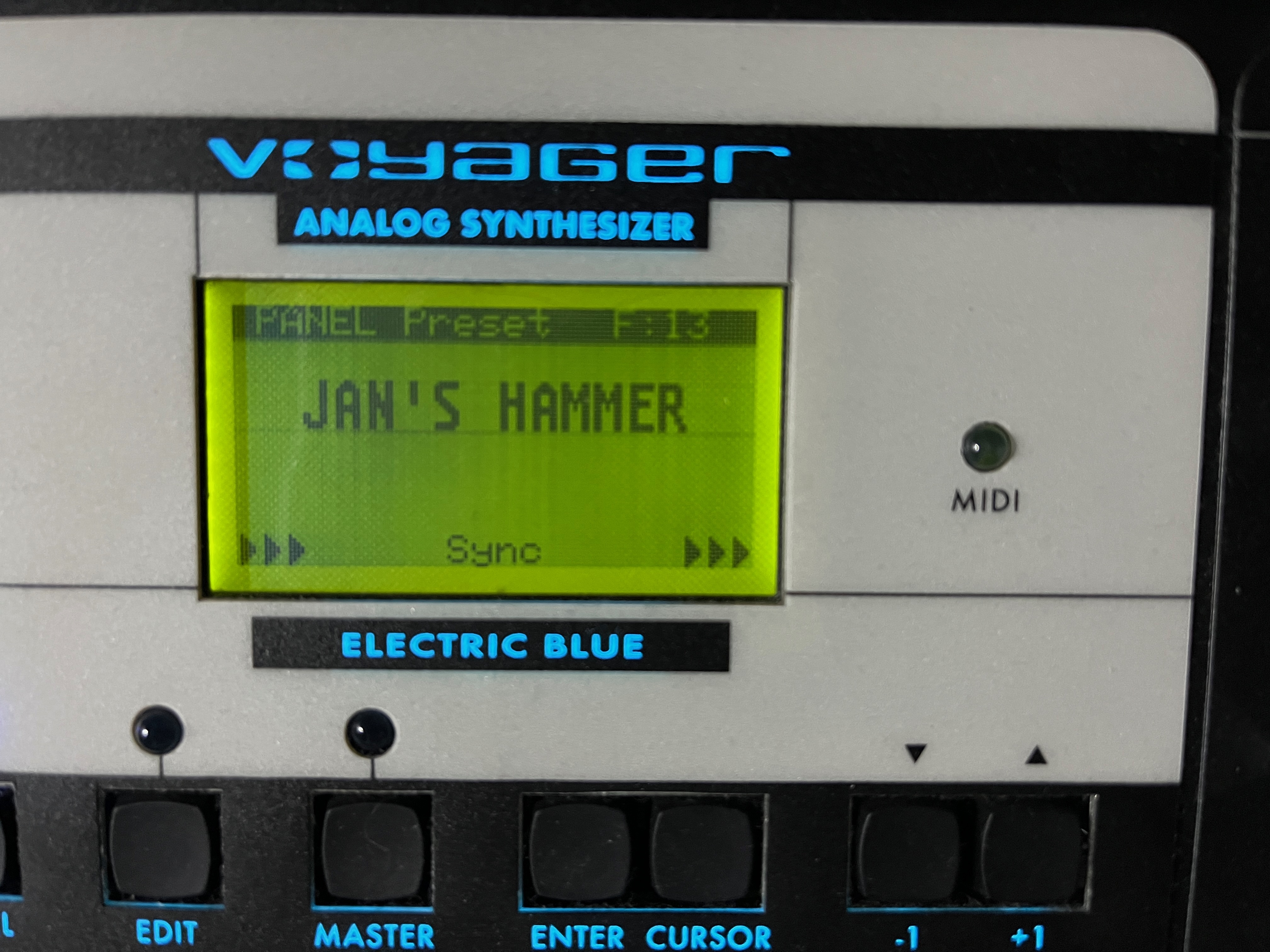

Thanks for your help; I just opened up the back of the Moog and found a ribbon cable that wasn’t seated correctly.
Everything is working like new again! Thanks for your help.
