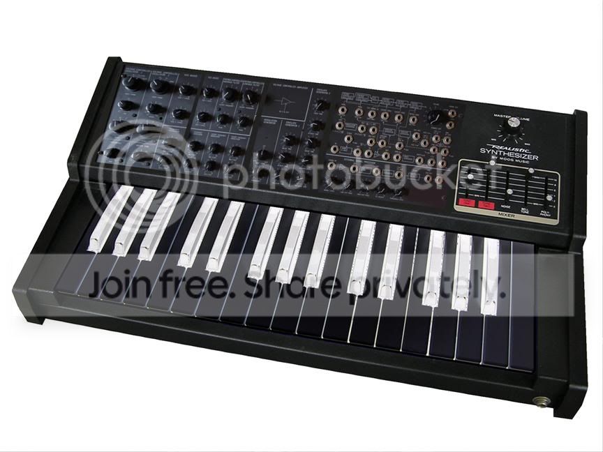

Allright, thank you guys, with your pointers, I was able to put it back like new … well almost! :sunglasses:
Nice “hack job” ! :smiley:
But you could at least have kept the Moog filter ! :open_mouth:
