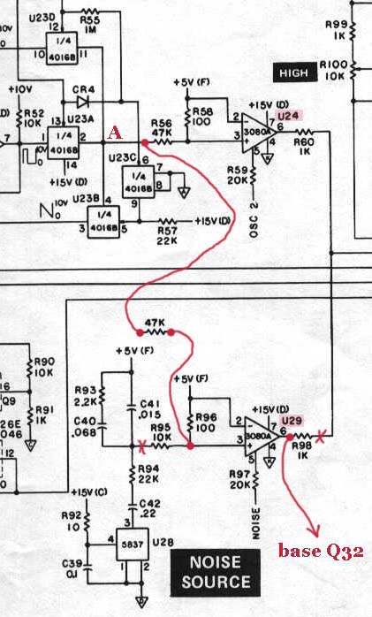

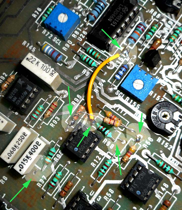

I had to try this MOD on my Source … adds a cool dimension !
notice that instead of un-soldering resistors, I simply snip one side
ie., only one lead is broken half way and the resistor sightly bent out of the way …
the yellow jumper and new resistor are soldered “on the fly” …
this way the mod can be reversed easily without wrecking the board
thx to analoguediehard, for posting info …
http://www.retrosynth.com/~analoguediehard/studio/keyboards/moog_source/
uploading my resources in case they’d be useful to someone else …
