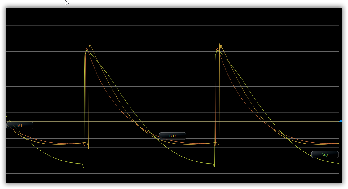

I don’t currently have a real D to compare, but I do have a Boog. The oscillators on the One are very very similar to the D. There is a slight difference in timbre in the mids (One has a touch more mids and slightly different voice in the 2ks). The Voyager is actually much much more pronounced in the low mids. The Boog has a touch more distortion at the wave transition point.
These are level matched at around - 6.8db with filters wide open. I got the voyager saw to as close to a saw as I could.
https://www.dropbox.com/s/715udtlsqprut5y/oscillator%20comparison.wav?dl=0
EDIT: I had to invert the Voyager saw .. I didn’t adjust properly after the inversion, so the Voyager is actually louder .. sorry about that.
IMO the real sound difference is in the mixer and the filter(s). The One Ladder is voiced closer to the Voyager. I’m not sure what to compare the SVF to. It has a unique range compared to other 12db stuff I have.

If there is one thing that I’ve learned over the many years of owning and playing many different synths, it’s that you cannot rely solely on traces on an oscilloscope to compare the overall sounds between them. You must trust your ears instead. Because they’re much better at hearing things than our eyes… :wink:
Best example of that: sometimes you might see a slight change in a waveform shape on the scope screen without hearing much difference, and sometimes you’ll hear a big difference without noticing such a big change on the screen.
But then again, as you said, this will probably fall on deaf ears anyway… :laughing:
The example was based on your statement that the oscillators were like a Voyager. They are not. They are voiced similar like a D. I also acknowledged that they sound a little different. Although your comment that it can’t do “D” is not because of the oscillators, it’s because of the mixer and filters. The Ladder filter however is closer to a Voyager, although not exact as far as I can tell with the spectrograms and of course using my ears. The One can do “D” for the majority of sounds ever put on a recording using a D. It just can’t do those edge case, highly distorted (in a good way) and filter wide open oscillating screeches. I also had no issue getting it to Polymoog sounds. Although again, the filters are a bit different. Anyhow, enough of that. I’ll go back to my One happily deaf.
Yup. Measurements in the frequency domain reveal a lot more. A standard 'scope measures in the time domain which isn’t enough.
You must trust your ears instead. Because they’re much better at hearing things than our eyes… > :wink:
The human ears can detect psychoacoustic audio phenomenon that can’t be measured on any measurement instrument. A good example is resultant tones. Tune two VCOs a fifth apart using low harmonic waveforms (IE triangle or sine, or heavily filtered ramp). Your ears hear a pitch an octave below the fundamental. That’s a resultant tone and is a trick used in pipe organs. But if you attempt to measure that pitch on a spectrum analyzer, it’s not there.
It is known that Moog engineers from the RA Moog days relied on their ears more than their measurement tools. A skill not always employed.

Ears are also responsible for horrible confirmation bias aliasing… :unamused:
I have actual oscilloscopes, tone generators etc.. For the practical purposes of the discussion the scopes and analysis tools on the computer through quality DACs is sufficient. The wave shapes on the One are NOT voyager shapes. They are closer to D shapes. The harmonic analysis has a couple of unique factors .. including a broader low bass and a upper mid push on the ONE. No need to be pico accurate to hear this to be true.
I know you are quite aware of this, so really posting to tother readers. All this stuff is true WHEN you master the oscillators/filters/envelopes and dial things in.
