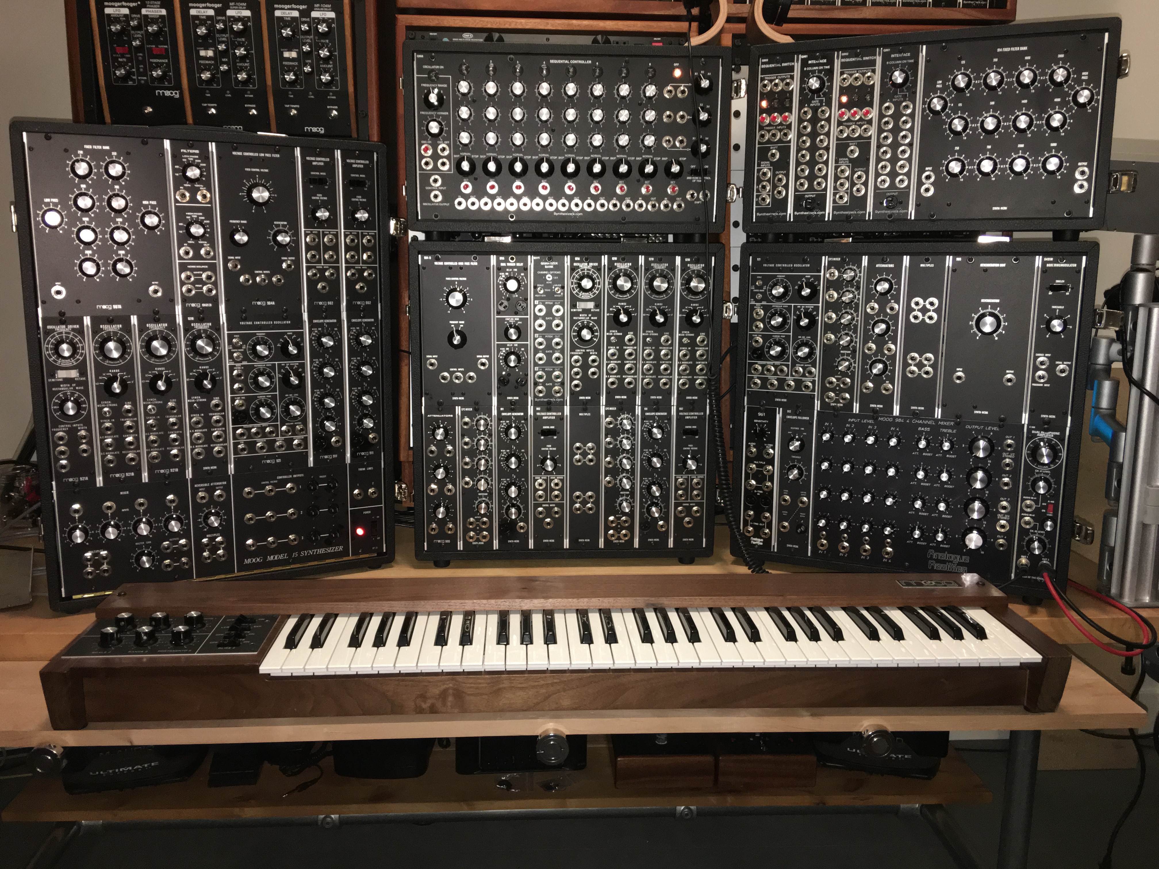

Gerhard at Synth-Werk makes excellent gear and I can’t recommend it highly enough. I purchased a lot of modules from him to expand my Model 15 and they are amazing! His modules all have on board regulators and mate with a standard Dot Com power supply and connector. He also knows exactly how to integrate his modules into vintage or the re-issued Moog systems and has instructions that come with his modules where needed. In addition to other modules, I put one of his 921-B VCOs in my Model 15 to make the Model 15’s a trio of 921-Bs instead of just two slave VCOs. It was simple and completely reversible to do this. Right now, I have his other modules in some Dot Com “Moog” cases, but I also just got on Gerhard’s list for a sequencer compliment, another full size portable power cabinet with some console modules, and two one module high, 8U expansion cabinets. I don’t know how Gerhard handles power in his new full size portable cabinets.

Also, How does his 921b sound in comparison with the Moog? Any noticeable differences? I feel like I remember reading that Synthwerk does a excellent job staying faithful to the original designs of the Moog modules. Any truth to this? Seems like you’re enjoying their stuff! Quite a beautiful set up! I’d love to see the pictures when your new stuff arrives! Check back in when it does!

I specifically listened to the Moog 921B against the Synth-Werk 921B and I honestly couldn’t hear a difference. I personally like Gerhard’s goal of staying true to the Moog designs. I think he has done an excellent job and the quality of his modules is amazing.
