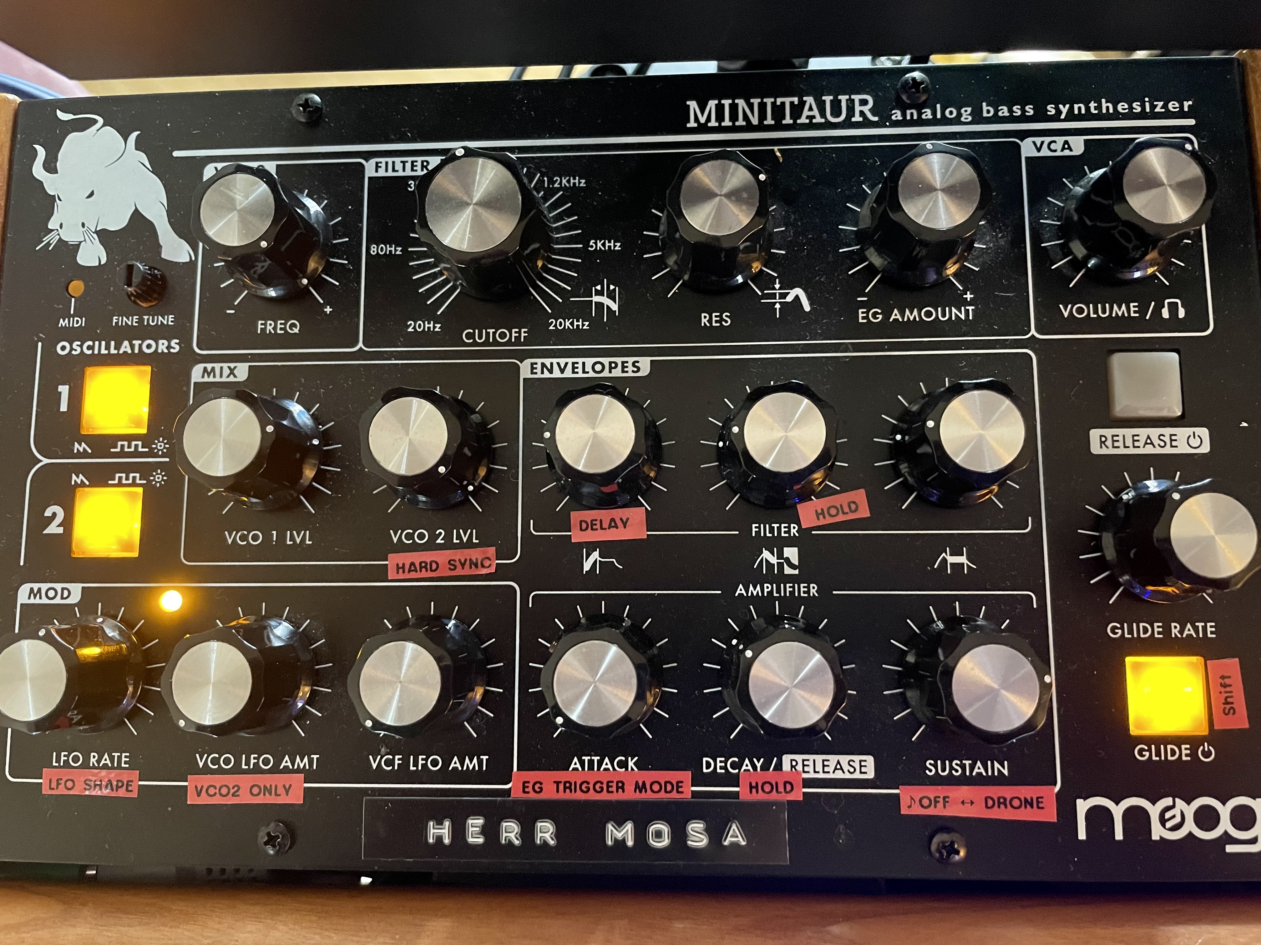

The editor is still doing fine in Win10. I Have “some Issues” with the Preset Manager under Mac OS Sequoia but i can still edit.
https://moogmusic-help.freshdesk.com/en/support/solutions/articles/69000840601-moog-editor-download-links
I did put on some stickers of some hitten functions i can’t remember for live use.

The editor still works fine for me on Windows 10 too. I’ve had some issues with the Preset Manager on macOS Sequoia, but nothing that stops me from editing. Still usable. I even added a few stickers for hidden functions I tend to forget during live use — makes it quicker in the heat of the moment.

Also, nice idea with the stickers for hidden functions! Might borrow that trick for live sets.
