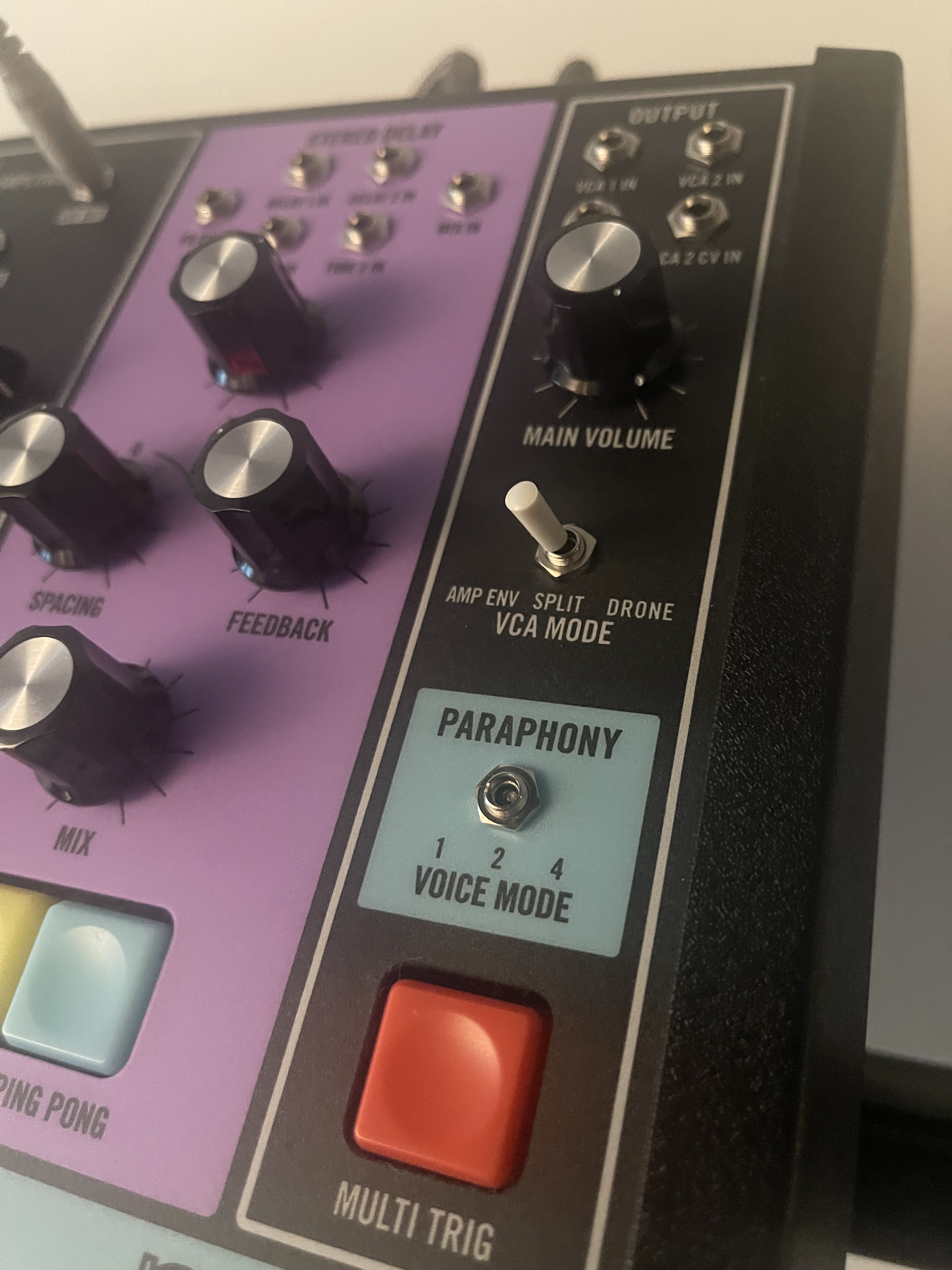

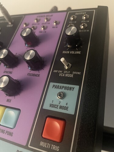

I recently broke one of the 3-way voice toggle switches(Paraphony Voice Mode) on my Moog Matriarch. I reached out to inMusic support to buy a replacement, but they informed me they don’t stock or sell the part directly and just handed me the internal manufacturing SKU: SWT-02-000-0019.
It doesn’t show up on standard retail searches. Has anyone here had to replace one of these switches before?

Bummer about the switch. Those toggles are usually a standard On-On-On 3-way SPDT or DPDT, so you might not need the exact SKU. If you can measure the pins and thread size, or trace the solder points on the board, you can likely match a generic one from Mouser or DigiKey. Posting a clear close-up of the switch pins here might help someone ID the exact spec. Good luck with the repair.
