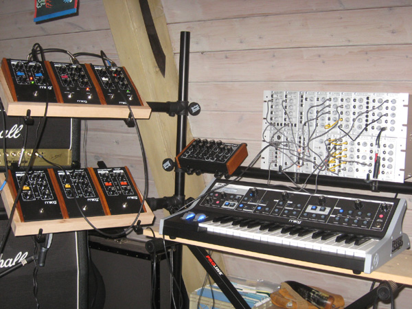

Well…This is the beginning of my modular foundation. I’ve been using my Little Phatty’s cv out and using a CP251 and two MF107’s as oscillators. The rest of the MF’s are for post signal/audio stuff. Last month I bought a Doepher system as a bass for the rest of my modular plans. I want to digest this system first and don’t plan on buy anything for the next year. After that, I plan on going with Makenoise. I’m a big fan of Rene’.
As far as five unit systems, I might add a few of those to add more variety to the Moogerfoogers. Some of the best bass sounds I get are from the two freq boxes. It makes me wonder if I already have a Taurus sound with the MF101. I would still like to add a third MF107 to the Moog system.
I’m real happy with what I have so far.
Hey Zenhead, and everyone.
Love your setup! I think this is the route I’m going to go down to be honest. I have a Phatty, a Prodigy (soon to be cv’d fitted) and a CP-251. I’ve got four VCOs with those two synths and then I was thinking Euro Rack modules for more mangling and processing.
The Foogers really do interest me. Just wondering what people thought was the best route initially… Get some Foogers or start up a Eurorack system?
With the Freqbox, what does that give you in terms of another oscillator? And when you are using it as one do you still use the other features it has?
