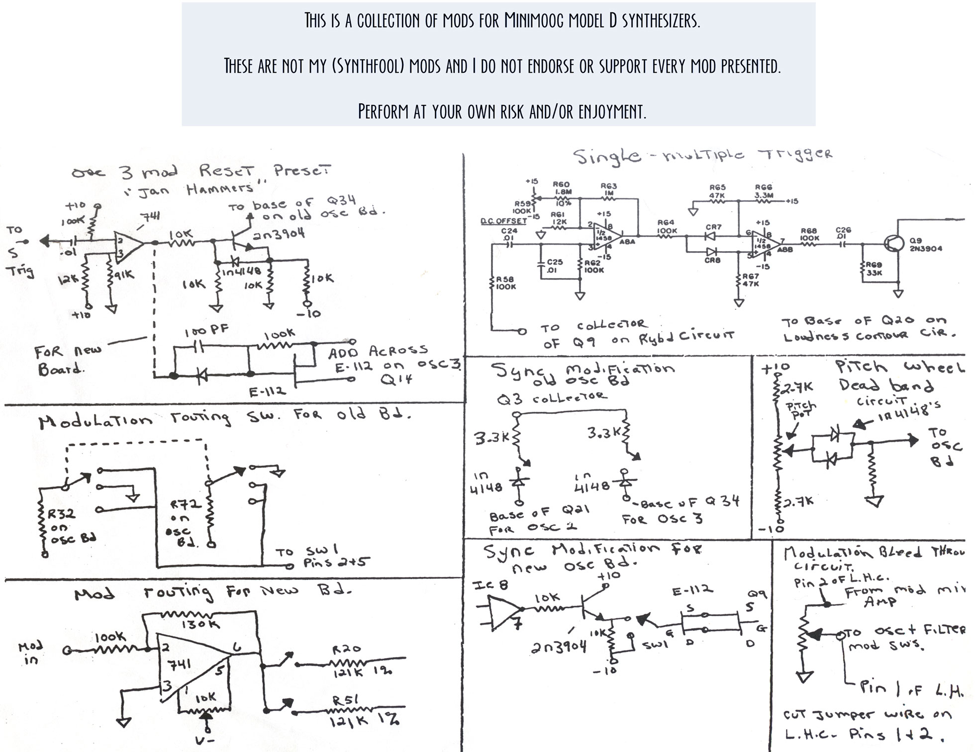

I added another scan to this directory.
It’s a compilation of several different mods for Mini D’s.
I’m not the author and don’t necessarily agree with every mod, but they’re still interesting if you’re into this stuff.
http://www.minimoog.net/minimoog_updates/more_mini_mods.jpg
