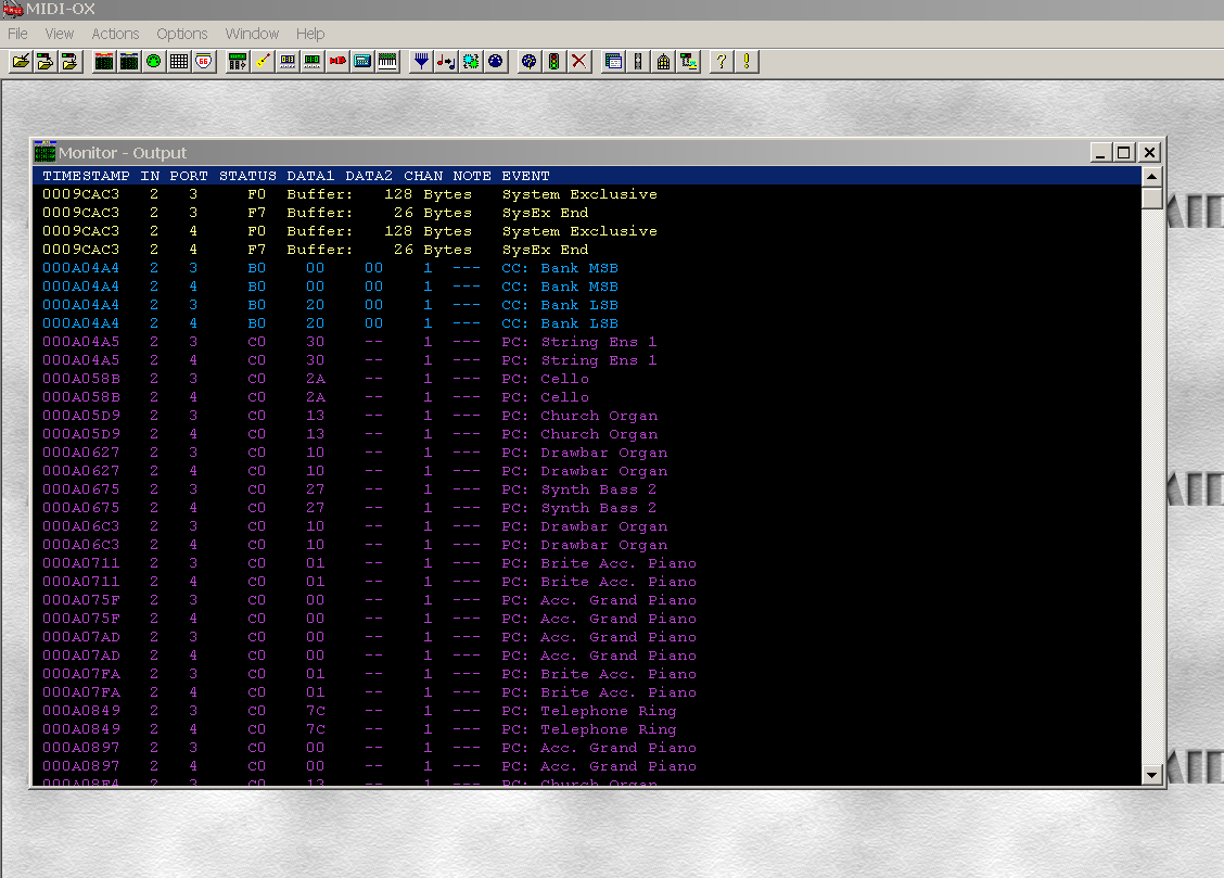

Here’s a screengrab:
Looking at the log window, it is recognizing the individual patch as a sysex file ( yellow ) but when I send a bank afterwards ( blue, then purple ) it displays no sysex information.
And the purple text has nothing to do with any of the patches I have on the Voyager. It’s like a ghost bank, or some kind of default bank list?
I tried setting the buffer to 1024 instead of 512, but it made no difference.
It appears to be sending the data twice, on ports 3 & 4. Maybe because I have my interface ( Roland octa capture ) set as the midi device and also the CTRL device in MIDI-OX. But it wasn’t working with just one selected either.
