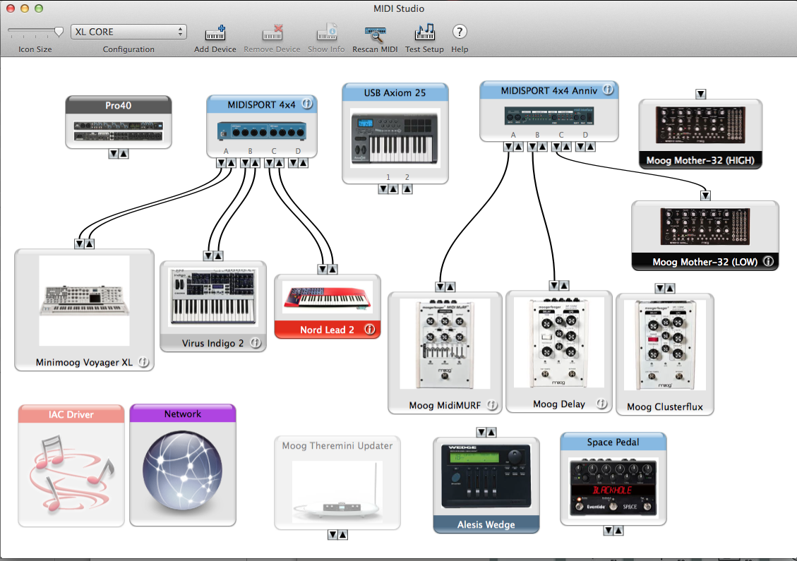

Anyhow, I’m hoping some of you can shed some light on this. I’m including a pic of my Audio Midi Setup to show how things are plugged up…
Are you sending MIDI beat clock or MTC? MTC could cause problems. You only need beat clock.
If any devices use active sensing, turn it off or filter it out.
If you can, monitor the MIDI output from Logic. Maybe something else is being sent.
It sounds like your devices are being hit with a datastorm.
Two quick guesses are that you are suffering some sort of MIDI loop or your interfaces aren’t up to it (I had lag problems with a simple 2*2). Try just one MIDIsport, try connecting less devices at once to narrow down the problem, and try disconnecting the MIDI out from the synths (one at a time) back to the interface.
