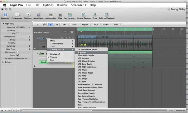

Time has run so fast…but, now, at least I succeeded to manage the 2 analog delay serie 500 …However, I still have a question regarding the automation of the parameters of the delay.
In the tutorial video of the Moog delay, Ben Lindell, using an older version of logic shows clearly ( at minute 6:0) that almost every parameters can be subject to automation….Fig 1

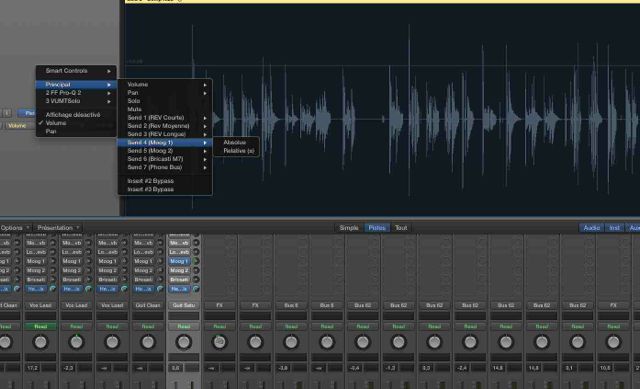

However, when I try to make the same with Logic 10.2.1 the only parameter that is display on the screen is the amount of dB…and I can’t see w anything else Fig 2

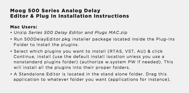

When you download the plugin , this windows appears…but when I expand the plugin…I do not have the choice where to place the plugins…only the disk..
Would someone be so kind as to help me to try to solve this issue..It would be of course much more interesting to have access to other parameters….
