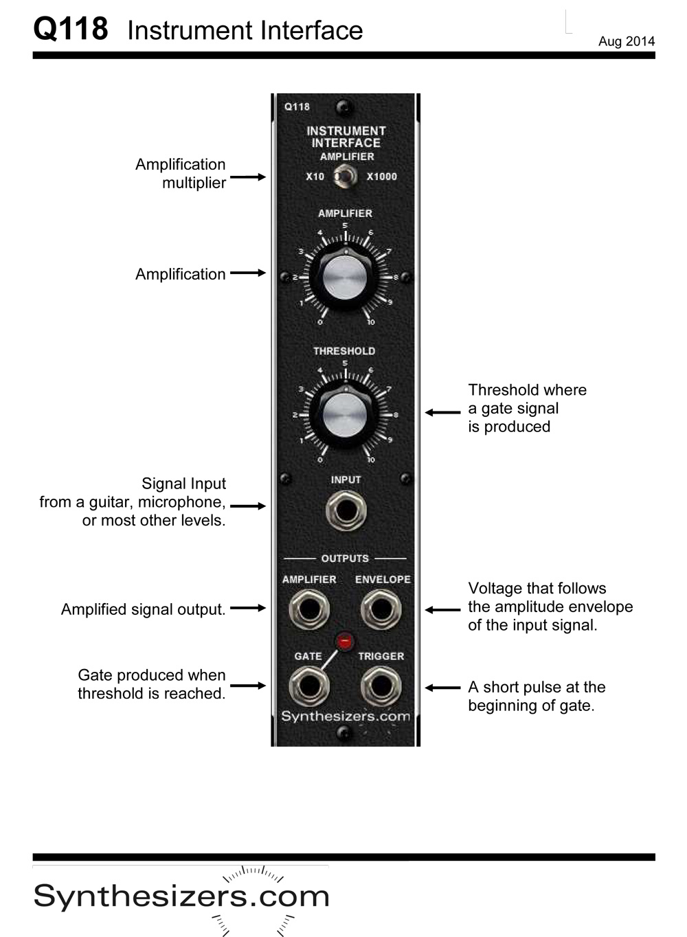

Well, there’s this:
All you really need is an amplifier to get the gain to 5V, a rectifier to remove the negative excursions, and a Cap & Resistor low pass to smooth out the original signal into some kind of envelope that would satisfy the kbd gate condition. Basically an envelope follower without a gate output. Add a one-shot and there’s your gate!
But if it was me, and it will be sometime this year when I add a 5U rack :slight_smile:, I’ll just buy an envelop follower like GregAE posted.
If you know how to build that, why would you buy something that is only going to cost more?
I value my time more. I did hardware for 35 years, I’m retired :slight_smile:
