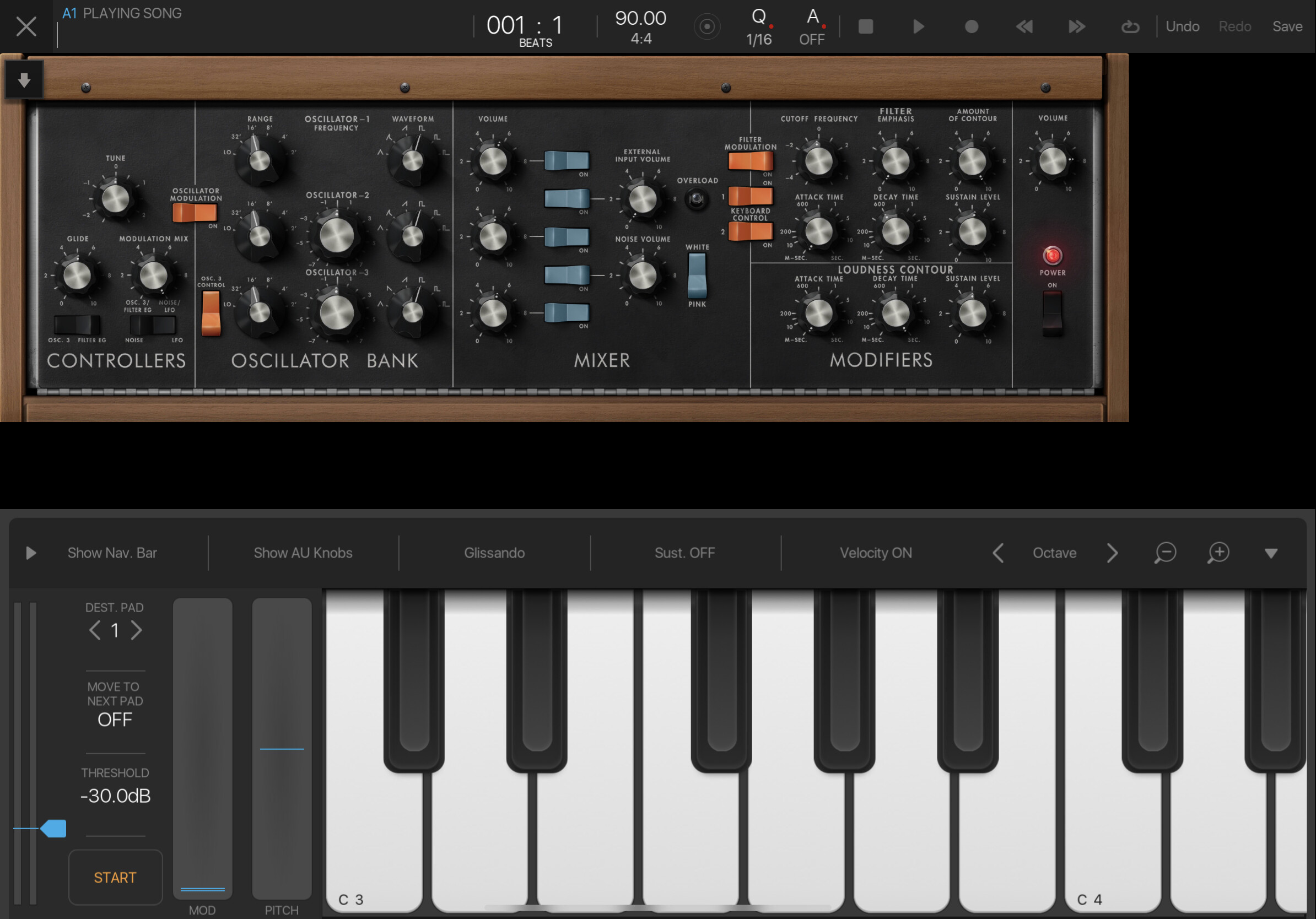

Yes, it does! Thanks for the update in general and the Model D Update in particular :slight_smile:
Although, it does look a bit weird in Beatmaker, see attached screenshot. Is this expected behavior?
Well, let’s hope that Apple gets its act together soon.
Yes, that is expected behavior. The Model D UI is not scalable.
