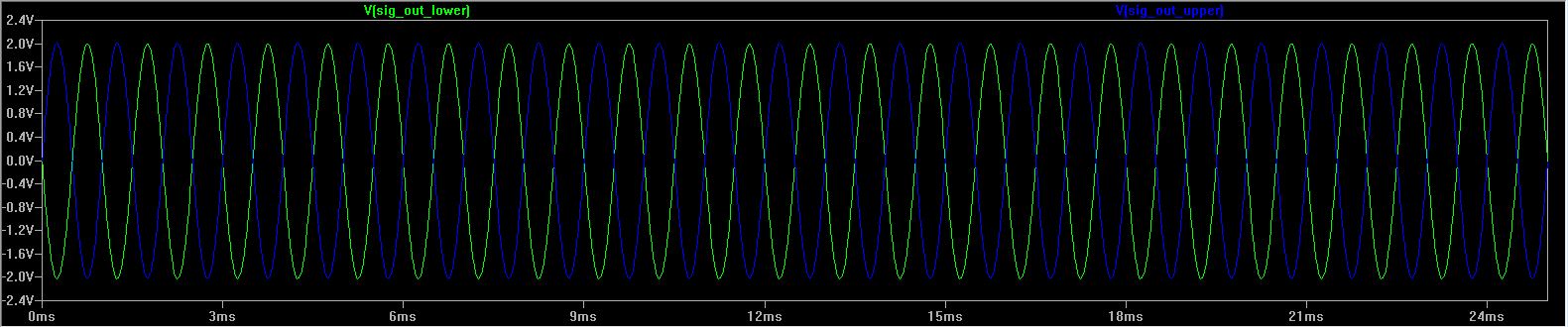

But in some cases the waveform of an inverted signal is identical to the same signal put out of phase for 180 degrees, e. g. if you look at a sine or a triangle. This is what I saw when I tested my 902 clone with a sine and a triangle signal and compared the outputs. Perhaps it was a bit confusing talking about phase differences, because indeed what the output amplifer of a 902 does is to INVERT a signal and not putting it 180 degrees out of phase. Only for symetrical waveforms like sine or triangle it is the same, a ramp for instance changes only if inverted but does NOT change if put 180 degrees out of phase.
Outputs of a 902 processing a sine: the inverted side looks like a sine beeing 180 degrees out of phase:
