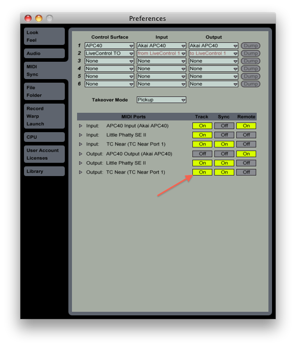

Also you may need to set some settings in the Preferences menu / MIDI-Sync tab
check the screenshot
You need to enable TRACK and SYNC for all MIDI ports you want to use to play midi tracks

So I’m basically trying to do the same thing with ableton and I can’t get it to work. I am using a DIGI 003 Rack as my interface. I have my LP plugged in via USB… Nothing. I set it up with all of the settings you used in those screen shots. I’m not getting any audio at all. Can someone help me out?
Ok, so now I am getting audio… But only after recording. It won’t let me hear the audio before or while I record.
Dude, why did you say to switch monitor to off? That’s why I wasn’t getting audio! lol
