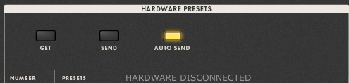

On starting editor with Sub 37 on, and then switching Sub 37 off the editor and librarian give no indication of the Sub 37 being off. If I then restart the editor with the Sub 37 off, I get the connect hardware message. Is this the expected behaviour?
Iain

I see that there is a indication when Sub 37 is switch off.
regards Luloop
Well, ideally it should work like this:
Sub 37 off → Editor On → Couldn’t Connect to the Hardware message → Sub 37 on → connected and controlled both ways
Sub 37 on → Editor On → connected and controlled both ways
Sub 37 on → Editor On → Sub 37 off → Hardware Disconnected notification → Sub 37 on → connected and controlled both ways
We know about an edge case on which the editor won’t reconnect when turning the Sub 37 off and back on, and are investigation it. It doesn’t work perfectly in all cases, but we will check into this again on 1.0.1.

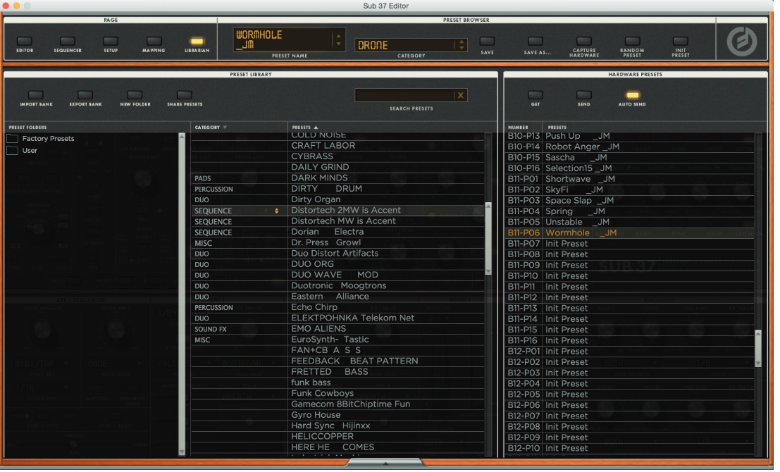

  1. Manual
  • new manual - whoo-hoo!
  • very nice!
Setup section
  • image - shows editor 0.9.37, fw 1.1.0
  • add a section to talk about local control and DAW ?
    (Ah. I see it later in the Plug-In section.)
    (important point, so repetition is good?)
Preset Library section
  • image shows a preset selected from the Hardware List, not the Preset List
  • image does not show the extra preset folders
  • Share Presets - “opens an email client” Hmm, sort of … not really.
  • can add description of keyboard commands for both folder navigation and HW List up/down
